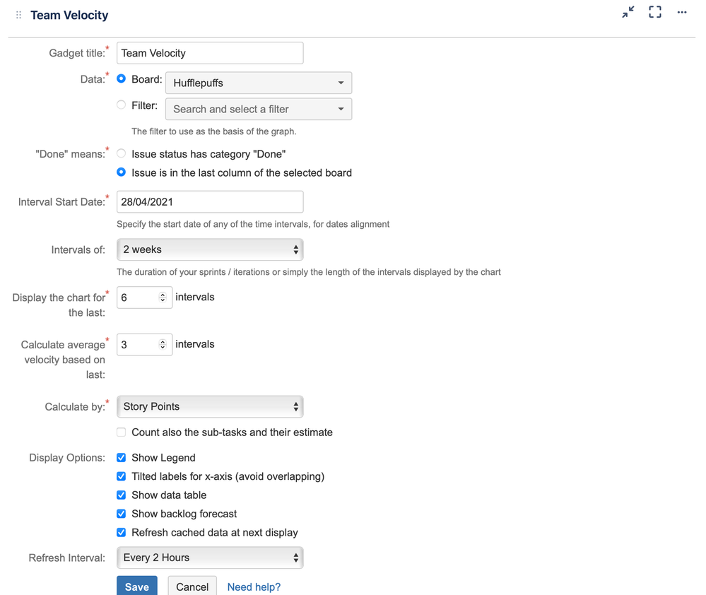

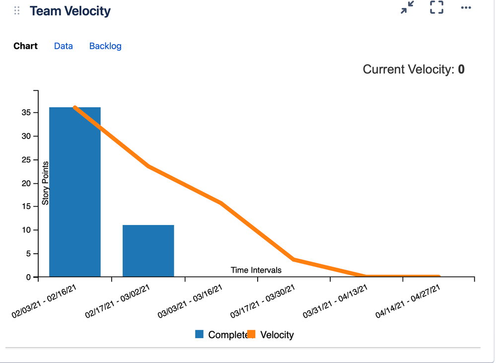

We are using Kanban Velocity Gadget for our Kanban project. We use as initial start date 4/28/2021 (MM/DD/YYYY format) of our iteration. The project started in 2020, during 2021 the project was on hold for two months and we resumed it on 4/28/2021. I would like to calculate the team velocity using the last three intervals (as a reference for future iterations), but the gadget doesn't show the current work we have done from 4/28/2021 until now. I was playing with some of the configuration parameters, but I am not able to find out why it doesn't show the work for the current interval.Screen Shot 2021-05-07 at 8.48.38 PM.png
Here is the configuration of the gadget:

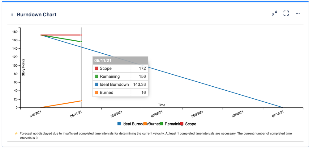

as you can see here, the Burndown chart is showing the progress we have made so far:

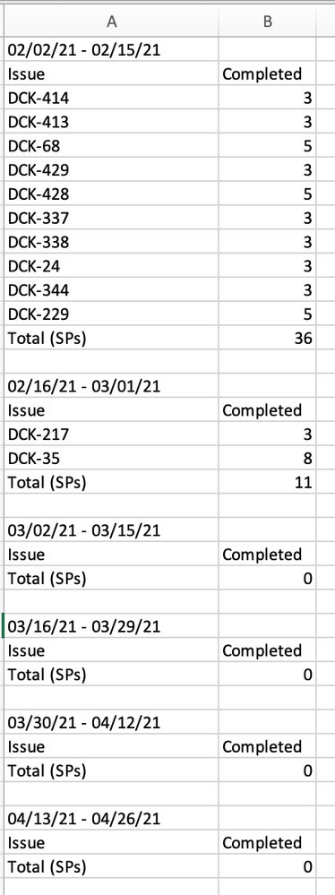

When I export from the gadget (Data) all the work counted, here is the information:
so as you can see the period the project was on hold, but I would expect it considers the interval from 04/28/2021 until today. By the way, it is not clear why the interval is split this way because the initial start date is 4/28/2021 so I would expect the previous interval would be from 4/13/2021 to 4/27/2021, but it shows: from 4/13/2021 to 04/26/2021.

Hi David,
The gadget displays only the past & completed time intervals that have the length specified at "Intervals of". The intervals are aligned to "Interval start date" - as mentioned it its description, this setting is just used for aligning the time intervals( by their start date).
In your example, you have Interval Start Date = 28/04/21 and Intervals of 2 weeks.
Because the gadget displays only the past completed 6 intervals, the last interval in the chart is [04/14/21 - 04/27/21] (aligned to 28/04/21), the previous is [03/31/21 - 04/13/21] and so on..., which is correct.
It does not display the data after 04/27/21, because the next 2-weeks long interval would be [04/28/21 - 05/11/21] is not completed yet! Today, when you visualize the chart, is 05/08/21... So the next interval will appear on 05/12/21, when it becomes completed.
Does it make sense now?
If you want to have recent data, re-align the intervals by changing Interval Start Date to date of today.
Indeed, it seems to be an issue in data tab, the dates from the report being displayed shifted with 1 day. We will investigate and correct this.

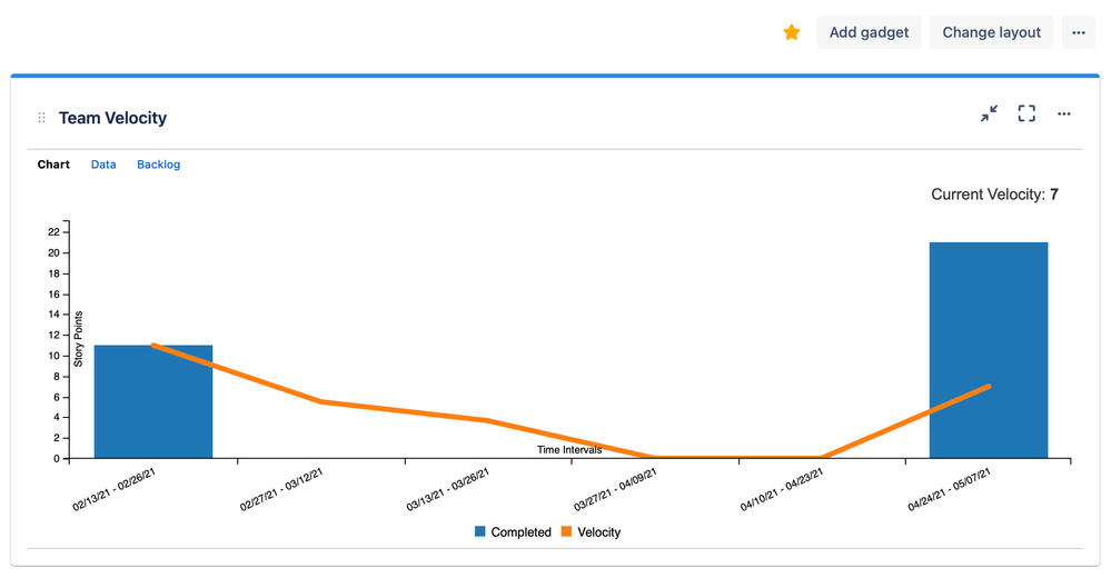

@Danut M _StonikByte_ thanks for your response. The word "completed" doesn't appear in the documentation I referred in my question to this specific gadget, so it is an underlying assumption. The workaround to show changing the initial date (changing every day the initial date to see the current progress), then miss-represents my real iteration periods starting from 4/28/2021.
As you can see from the graph now the iterations interval doesn't represent my real intervals:
