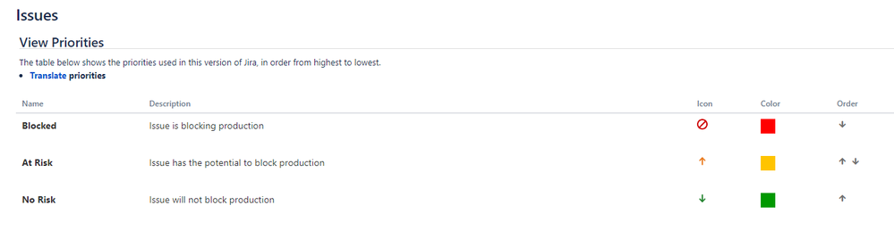

I am having issues with the Quick Filter Order By command. Priorities are customized as below:

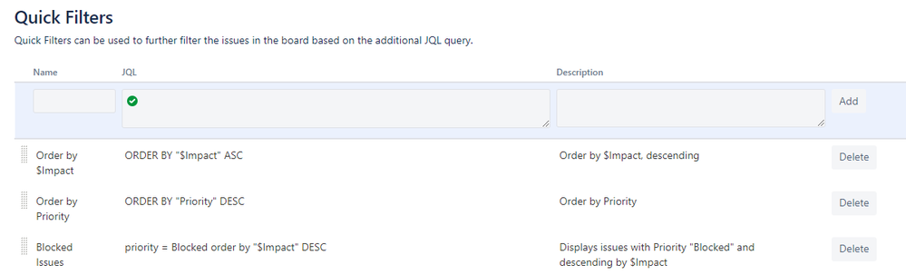

Capture01.PNGMy Quick Filter is set up as below:
Capture02.PNG$Impact is a custom number field.

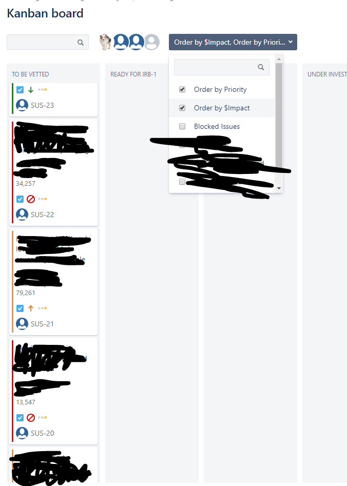

When I activate these Quick Filters in the KanBan board, the issues are not actually sorted. See below:
Capture03.PNGAs you can see, the Priority filter does not work, as the order goes from Blocked to At Risk to Blocked again. Also, the $ Impact does not work, as the number value (shows on the card) goes low-high-low.
I'll note that the third filter shown (Blocked) does work, and when I click that, only Blocked issues show up, as expected.

I am afraid you cannot sort by using a quick filter. Either you are fine using a quick filter for displaying high priorities, or you can edit the board filter and add the "ORDER BY" there, but you will not be able to change it when viewing the board.

Ah, I see now what you are saying. I hadn't realized that there was also a global filter option. I have now set the default filter to order by priority and $impact as we will likely always want that view. Then, I can use quick filters to only display certain priorities if we want a detailed view otherwise.

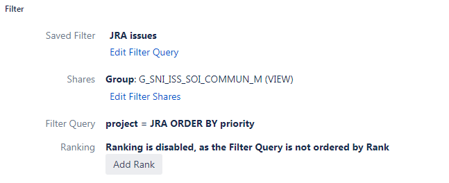

By default, the board is ordered by rank. You should be able to order by another field by editing the board filter (see attachment). Unfortunately you will not be able to re-arrange the ordering of the board by using quick filters.
Quick filters will only let you exclude some values (as you did with "Blocked issues").
