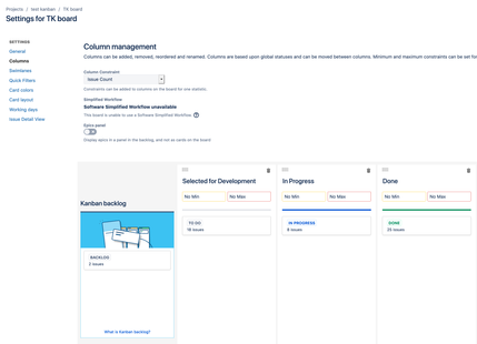

2 - Once your workflow is configured, you must map the correct status to each view and board column. To do it, Navigate to your board > ... > Board settings > Columns:
Map the backlog status in the backlog column so it will be the only status displayed in the backlog view. Additionally, map the other statuses to their respective columns:
