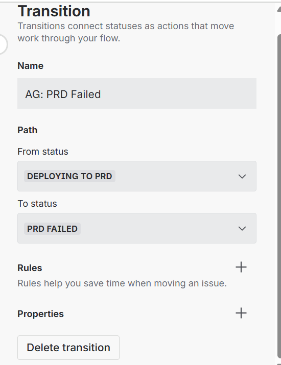

MAHAMMAD AZEEM
September 2, 2025
Hi Marc,
This particular transition doesn't have rules or properties et
it's a plane transition.
Issue security meaning are you referring to permssion schemes ?
if yes then this project doesn't have any permissions associated.

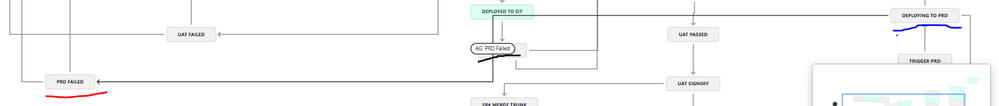

MAHAMMAD AZEEM
September 2, 2025
Hi @Marc -Devoteam-
Here is the screenshots.
Below is the error i received when i ran the curl/rest api from cli/manually.
