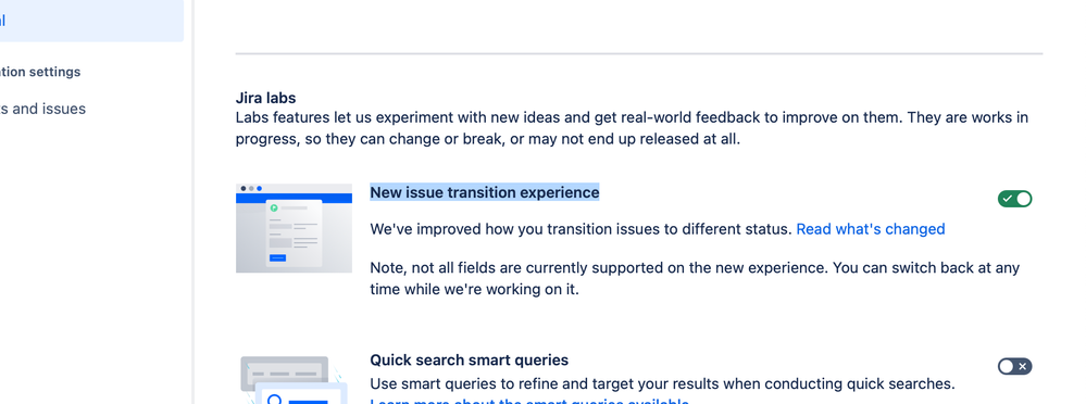

Hello James, Good day. As this screen works fine if you drag and drop the issue between columns in the board, this confirms permission is good. Are you noticing any error when you try from issue view ?
Also try to disable "New issue transition experience" and check the status.
https://xxxxxx.atlassian.net/jira/settings/personal/general

Thanks Mohanraj,
The new issue transition is disabled but I still see the issue described. The only additional thing that appears strange is that in the Chrome devtools > network I found an error where the name of the error is the 3 char project code in Jira and the error reads:
"errors": [
"errorMessage": "The service project you are trying to view does not exist."
"reasonKey": "sd.jsm.agent.servicedesk.error.servicedesk.missing",
"reasonCode": "404"
I have no idea if this is causing a conflict. I checked all my fields configuration on this issue and have not used any JSM fields. May be it is not related, but maybe it is a clue.

Thanks James. This error does not relate to the issue that you are noticing. Kindly confirm that Edit screen has all required fields as well.
Mohanraj Thangamuthu
October 30, 2024
We have reported a similar issue to backend team. Will update here once this issue has been fixed. Thanks
