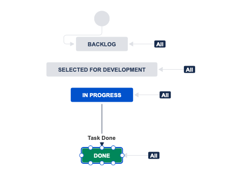

It is possible to have more that one transition defined between the same workflow statuses that can have different behaviours
You can set a condition on each transition e.g. "Task Done" has condition  `IssueType = Task`,  "Done" has condition `IssueType != Task`
and define a different transition screen for each. Task Done can have Log Work fields present.
You can also add a validator to check the field "Time Spent" has had a value set to ensure work is logged.

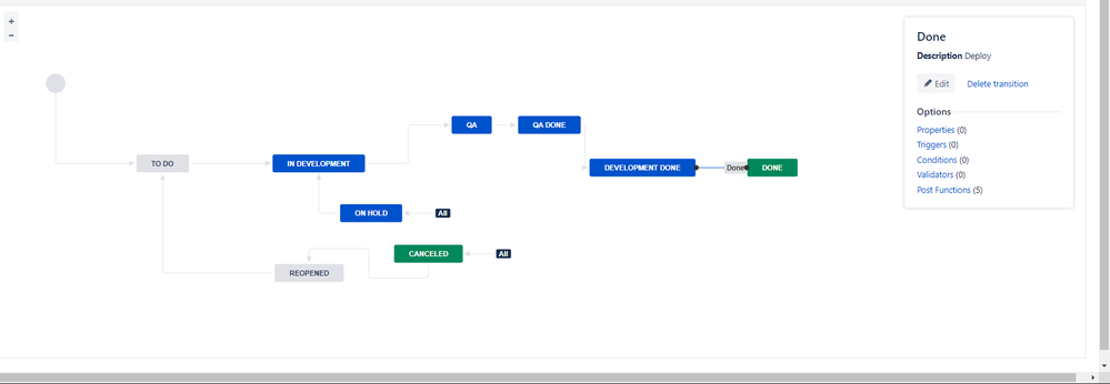

but it has to be only when task issuetype is going to done, so first of all i cant make a condition in the workflow for that (or i cant find an option for that) and second of all i wont give me a  result of the pop up screen i need
Artem Snisar
November 6, 2022
Tom Lister
November 6, 2022
Currently you have one transition going to Done.
In my example you create a second transition called "Task Done" from Development Done to done.
Do you know how to do that?

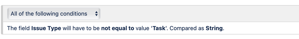

Edit the original transition and add a condition to check that issue type is not = Task to allow for all other issue types

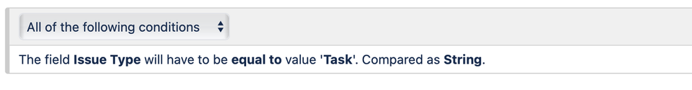

Edit the Task Done transition to check the issue type is only Task
