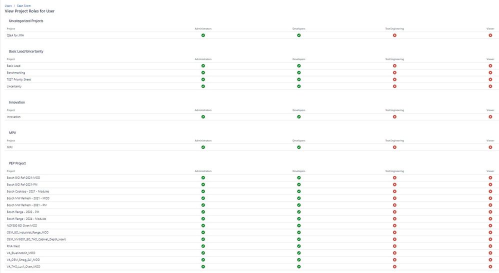

First off I just want to say that I am the Jira admin. I have a user that created a filter that includes multiple projects that they want to use to run sprints. However the user (Scott) does not have the ability to create/ start-Stop/ Edit a sprint. Funny thing is that I can do all the functions on the board and he has more access than I do for the projects. Unless its because I am an Admin.

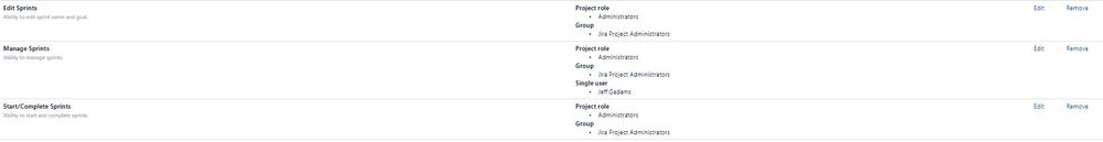

Permissions - Manage, edit, Start/ Stop - Role based and Group based (Jira Project Admin). User is in both.
Projects permissions - User is in the admin role of all projects that are included in the filter (best I can tell).
Project Roles for user:Proj 1.JPG
I know that I am missing something simple somewhere. I just cannot figure out where. I know its a complex search but with all the permissions set it should allow it,

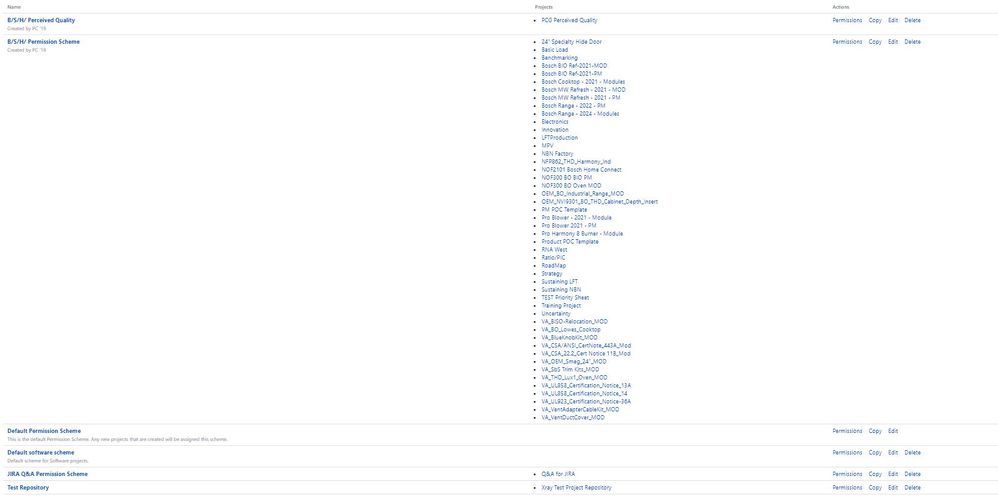

If you check your permission schemes being applied, I assume Manage Sprints is allowed on all projects for Jira Admins, which is why it works fine for you.

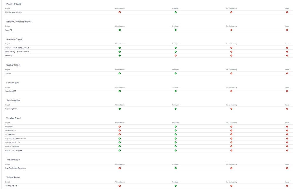

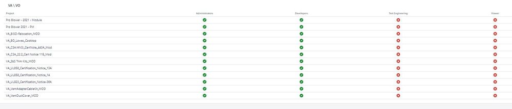

Is there a way to see all the projects that jira (thinks) it is pulling in. I have checked on all the projects that I think are in the query and he has permissions on all. See the project roles attached. I use the same permission scheme on all projects. I went through the projects 1 by 1 and checked the permissions on each and it came back good. The part I dont understand is our Jira admins are not in the Project Admin role and yet i can do all. I will keep checking again and see if I missed 1. Thanks for the reply.

Hey @Joseph Hoskins  can you share your permission scheme settings (particularly around manage sprints permissions) please? This is where the issue probably lies.
Joseph Hoskins
February 3, 2021
It is in the original post but here it is again.
This same scheme is used for all projects except for two. Those two are not in the Query.

I painstakingly went through all projects and permissions and found 1 project that the user had an issue in and did not have admin rights. The issue was closed but i guess the potential for the project to be included was there.
