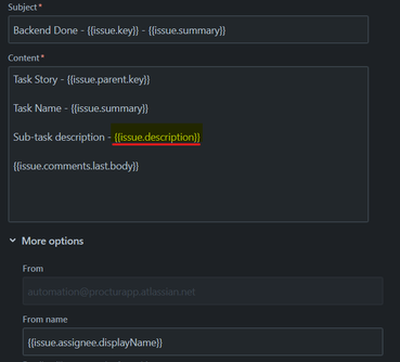

I have created an automation rule
It will be triggered when issue is transitioned to Done status - the rule will crosscheck the issue type and component and send an email.
All the smart values return the content except the {{issue.description}} one. What could be the reason?
Ive tried adding the description while creating the subtask itself but it still doesnt return the ticket description.
Please let me know what else I can try and what could be the reason.

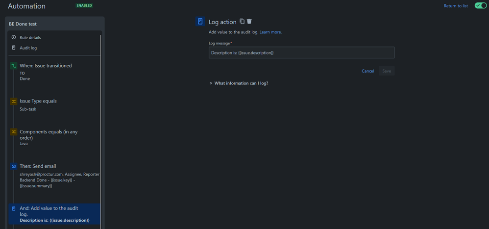

Here is the entire automation rule.

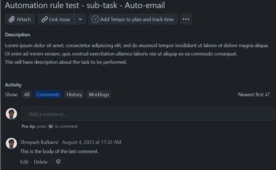

Here is the subtask description and comment

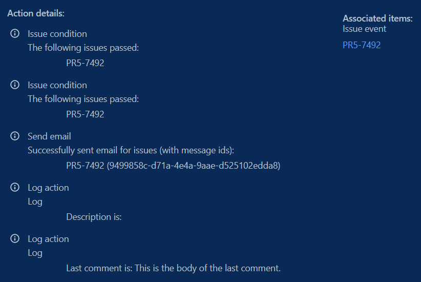

@Jack Brickey I have added log action to the rule and checked the audit log.

I note that your email component uses Summary. Does that work? Does the email have the Summary? The log component references Description and is blank which, unless the Description is indeed blank, has me scratching my head. It works ok for me. At this point I would suggest the following actions:

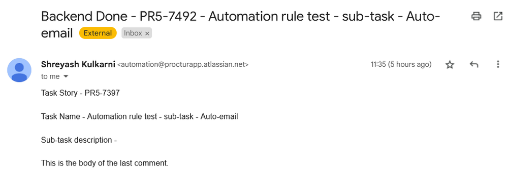

The description has not been blank in the issue ticket almost dozen times I have tested this rule but it is blank in the email.
This is the auto mail
