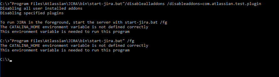

cmd line.PNGJira site.PNGA few days ago our locally installed Jira on Windows Server 64 bit stopped functioning (can't load the site). The last log that was written has the error: java.util.zip.zipexception: error in opening zip file.
I have backed up our old database, uninstalled and deleted Jira's folder then reinstalled Jira. If Jira uses the newly created database, Jira will load and try to set everything up normally. If i replace the new empty database with our original database, I get the same java error as before.
I have attempted to launch Jira with all of of the plugins disabled as per the troubleshooting instructions but then i get in command prompt "The Catalina_Home environment is not defined correctly".
I have found this link that says i need to set Catalina_Home but doesn't really explain what to do other than "Edit setenv.sh and set your CATALINA_HOME accordingly."https://community.atlassian.com/t5/Off-topic-questions/The-CATALINA-HOME-environment-variable-is-not-defined-correctly/qaq-p/398487
This is the point where I am stuck. Am I on the right path? Seems like an odd thing to just stop functioning one day.

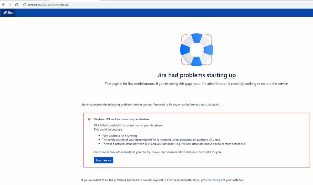

  • You need to  make sure  that  dbconfig.xml  is correct,  you  can find it in <jira_home_dir> i.e  the (user,password)  to connect JIRA  to  database  is correct,
  • That  the database server is up and running.
  • No firewall blocking TCP  connection database port.

I have updated dbconfig.xml to use my admin credentials but still no luck. I get the same page error as before.
I have stopped and started the server.
I am using the the localhost:8080 to access the database which is on the local C drive so there shouldn't be any firewall issues.
Is there anything else i should try?

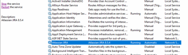

Yes it is an H2 db.
When you say check if it is running, do you mean the Atlassian Jira service?  If so I have started and stopped the service multiple times.

The next is to  go back to  the  "CATALINA_HOME"  environment variable is not set  correctly.  i.e  is the path the same with  the installation directory?
and 'CATALINA_HOME"   should be the full path for the JIRA installation directory
it should look like this  C:\Program Files\Atlassian\JIRA"
so make sure it is the same and then start Jira service.  You can also check  environment variables in  Windows.

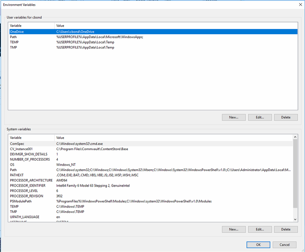

here is a screenshot of the environment variables. Is this what you are asking for?EV.PNG
Moses Thomas
May 28, 2020
@Cory Bond

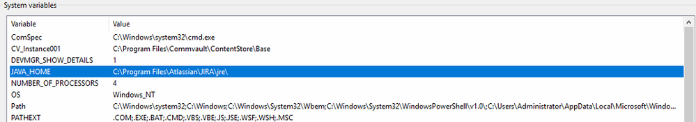

Yes  could you scroll  down to check  whether there   is  JAVA_HOME  or JRE_HOME   set in the  system variables.
for the setenv.bat " it says  JAVA_HOME=C:\Program Files\Atlassian\JIRA\jre\
because  i think you install  JIRA via the atlassxx.bin  file  so JAVA is packed together
JIRA need java_home/jre_home  to be set  in the environment variables for it to run.
 check  the right path to  verify  whether the path C:\Program Files\Atlassian\JIRA\jre\     exist  and  scroll  down to check  whether there   is  JAVA_HOME  or JRE_HOME   set in the  system variables.  if  you don't have it  then add  new
variable name :  JAVA_HOME
variable value:  C:\Program Files\Atlassian\JIRA\jre\
if  the  path exist then edit  to verify the path is correct.
Setting the JAVA_HOME Variable in Windows
Please try and give feed back.

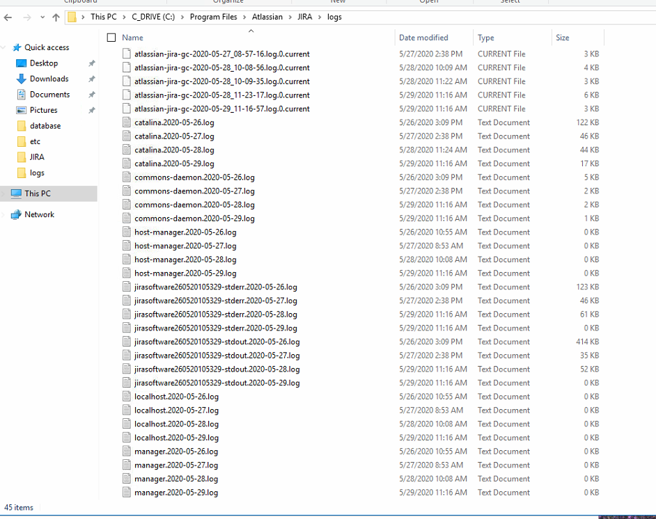

I have made the change in Enviorment Variables, stopped and started the Jira service, but am still having the same "Jira had problems starting" page.
Are there any logs you would like to see that may help?

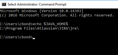

@Cory Bond  Does this path truly exist ?   if  yes  what do you get when you
from  the command prompt  type
echo %JAVA_HOME%
 you should get the path,  if not  try restart  host
then check  again  if  it doesn't work  then please provide  logs in   <jira_home_folder>/logs/
Cory Bond
May 28, 2020
Here is the output of the command.
Moses Thomas
May 28, 2020
@Cory Bond  The path is not updated please see my  previous comment
Try restart the whole jira server(machine)
Try again check java home  if it appear  then restart service (Jira)
If it doesn't work  I need to  see logs in logs in <jira_home_folder>/logs/
Also  show the service.bat   file

I have restarted the VM, now the Java_Home shows up. However still no luck.
What in the logs do you need?
Service.bat

Moses Thomas
May 29, 2020
@Cory Bond   There should be logs  in this folder  C:\Program Files\Atlassian\Application Data\JIRA\log\atlassian-jira.log
Please provide this logs, there could be valuable info there
Kind regards,
Mo
Cory Bond
May 29, 2020
I'm unable to post the entire log as it's too big but here is the portion just for today.
2020-05-29 11:16:56,006-0500 localhost-startStop-2 INFO [c.a.jira.startup.DefaultJiraLauncher] Stopping launchers

2020-05-29 11:17:04,147-0500 JIRA-Bootstrap INFO [c.a.j.config.database.SystemDatabaseConfigurationLoader] Reading database configuration from C:\Program Files\Atlassian\Application Data\JIRA\dbconfig.xml
2020-05-29 11:17:04,194-0500 JIRA-Bootstrap INFO [c.a.j.config.database.DatabaseConfigHandler] Trying to get encrypted password from xml and decrypt it
2020-05-29 11:17:04,209-0500 JIRA-Bootstrap INFO [c.a.j.config.database.DatabaseConfigHandler] Database password decryption not performed.
2020-05-29 11:17:04,537-0500 JIRA-Bootstrap ERROR [c.a.config.bootstrap.DefaultAtlassianBootstrapManager] Could not successfully test your database:
org.h2.jdbc.JdbcSQLException: File corrupted while reading record: "C:/Program Files/Atlassian/Application Data/JIRA/database/h2db.mv.db". Possible solution: use the recovery tool [90030-185]
at org.h2.message.DbException.getJdbcSQLException(DbException.java:345)
at org.h2.message.DbException.get(DbException.java:168)
at org.h2.mvstore.db.MVTableEngine.init(MVTableEngine.java:116)
at org.h2.engine.Database.getPageStore(Database.java:2379)
at org.h2.engine.Database.open(Database.java:666)
at org.h2.engine.Database.openDatabase(Database.java:266)
at org.h2.engine.Database.<init>(Database.java:260)
at org.h2.engine.Engine.openSession(Engine.java:60)
at org.h2.engine.Engine.openSession(Engine.java:167)
at org.h2.engine.Engine.createSessionAndValidate(Engine.java:145)
at org.h2.engine.Engine.createSession(Engine.java:128)
at org.h2.engine.Engine.createSession(Engine.java:26)
at org.h2.engine.SessionRemote.connectEmbeddedOrServer(SessionRemote.java:347)
at org.h2.jdbc.JdbcConnection.<init>(JdbcConnection.java:108)
at org.h2.jdbc.JdbcConnection.<init>(JdbcConnection.java:92)
at org.h2.Driver.connect(Driver.java:72)
at java.sql.DriverManager.getConnection(DriverManager.java:664)
at java.sql.DriverManager.getConnection(DriverManager.java:247)
at com.atlassian.config.bootstrap.DefaultAtlassianBootstrapManager.getTestDatabaseConnection(DefaultAtlassianBootstrapManager.java:347)
at com.atlassian.jira.config.database.JdbcDatasource.getConnection(JdbcDatasource.java:219)
at com.atlassian.jira.config.database.DatabaseConfig.testConnection(DatabaseConfig.java:88)
at com.atlassian.jira.health.checks.DbConfigurationAndConnectionCheck.doPerform(DbConfigurationAndConnectionCheck.java:60)
at com.atlassian.jira.health.HealthCheckTemplate.perform(HealthCheckTemplate.java:23)
at com.atlassian.jira.health.DefaultHealthCheckExecutor.runCheck(DefaultHealthCheckExecutor.java:74)
at com.atlassian.jira.health.DefaultHealthCheckExecutor.lambda$applyAndCollectExceptions$1(DefaultHealthCheckExecutor.java:53)
at java.util.stream.ForEachOps$ForEachOp$OfRef.accept(ForEachOps.java:184)
at java.util.stream.ReferencePipeline$2$1.accept(ReferencePipeline.java:175)
at java.util.Iterator.forEachRemaining(Iterator.java:116)
at java.util.Spliterators$IteratorSpliterator.forEachRemaining(Spliterators.java:1801)
at java.util.stream.AbstractPipeline.copyInto(AbstractPipeline.java:481)
at java.util.stream.AbstractPipeline.wrapAndCopyInto(AbstractPipeline.java:471)
at java.util.stream.ForEachOps$ForEachOp.evaluateSequential(ForEachOps.java:151)
at java.util.stream.ForEachOps$ForEachOp$OfRef.evaluateSequential(ForEachOps.java:174)
at java.util.stream.AbstractPipeline.evaluate(AbstractPipeline.java:234)
at java.util.stream.ReferencePipeline.forEach(ReferencePipeline.java:418)
at com.atlassian.jira.health.DefaultHealthCheckExecutor.applyAndCollectExceptions(DefaultHealthCheckExecutor.java:53)
at com.atlassian.jira.health.DefaultHealthCheckExecutor.performHealthChecks(DefaultHealthCheckExecutor.java:42)
at com.atlassian.jira.health.HealthChecks.executeChecksAndRecordResults(HealthChecks.java:164)
at com.atlassian.jira.health.HealthChecks.runHealthChecks(HealthChecks.java:154)
at com.atlassian.jira.health.HealthChecks.runHealthChecks(HealthChecks.java:66)
at com.atlassian.jira.startup.BootstrapContainerLauncher.start(BootstrapContainerLauncher.java:48)
at com.atlassian.jira.startup.DefaultJiraLauncher.preDbLaunch(DefaultJiraLauncher.java:117)
at com.atlassian.jira.startup.DefaultJiraLauncher.lambda$start$0(DefaultJiraLauncher.java:103)
at com.atlassian.jira.util.devspeed.JiraDevSpeedTimer.run(JiraDevSpeedTimer.java:31)
at com.atlassian.jira.startup.DefaultJiraLauncher.start(DefaultJiraLauncher.java:102)
at com.atlassian.jira.startup.LauncherContextListener.initSlowStuff(LauncherContextListener.java:154)
at java.lang.Thread.run(Thread.java:748)
Caused by: java.lang.IllegalStateException: File corrupted in chunk 2926553, expected page length =< 1024, got 761885485 [1.4.185/6]
at org.h2.mvstore.DataUtils.newIllegalStateException(DataUtils.java:773)
at org.h2.mvstore.Page.read(Page.java:640)
at org.h2.mvstore.Page.read(Page.java:194)
at org.h2.mvstore.MVStore.readPage(MVStore.java:1830)
at org.h2.mvstore.MVMap.readPage(MVMap.java:736)
at org.h2.mvstore.Cursor.fetchNext(Cursor.java:150)
at org.h2.mvstore.Cursor.next(Cursor.java:50)
at org.h2.mvstore.MVStore.readFileHeader(MVStore.java:696)
at org.h2.mvstore.MVStore.<init>(MVStore.java:357)
at org.h2.mvstore.MVStore$Builder.open(MVStore.java:2769)
at org.h2.mvstore.db.MVTableEngine$Store.<init>(MVTableEngine.java:162)
at org.h2.mvstore.db.MVTableEngine.init(MVTableEngine.java:98)
... 44 more
2020-05-29 11:17:04,553-0500 JIRA-Bootstrap ERROR [c.a.jira.health.HealthChecks] JIRA couldn't connect to your database
2020-05-29 11:17:04,553-0500 JIRA-Bootstrap ERROR [c.a.jira.health.HealthChecks] JIRA failed to establish a connection to your database.
This could be because:
- Your database isn't running
- The configuration of your dbconfig.xml file is incorrect (user, password, or database URL etc.)
- There is a network issue between JIRA and your database (e.g. firewall, database doesn't allow remote access etc.)
There are several other solutions you can try, review our documentation and see what works for you.
2020-05-29 11:17:04,569-0500 JIRA-Bootstrap INFO [c.a.jira.startup.JiraStartupLogger] Running JIRA startup checks.
2020-05-29 11:17:04,569-0500 JIRA-Bootstrap FATAL [c.a.jira.startup.JiraStartupLogger] Startup check failed. JIRA will be locked.
2020-05-29 11:17:04,631-0500 JIRA-Bootstrap INFO [c.a.jira.startup.LauncherContextListener] Memory Usage:
Heap memory : Used: 278 MiB. Committed: 919 MiB. Max: 2029 MiB
Non-heap memory : Used: 39 MiB. Committed: 63 MiB. Max: 1536 MiB
TOTAL : Used: 318 MiB. Committed: 982 MiB. Max: 3565 MiB
2020-05-29 11:17:05,709-0500 http-nio-8080-exec-1 WARN anonymous 677x1x1 - 10.242.2.6 /secure/johnson/data [c.a.j.config.properties.ApplicationPropertiesStore] Exception getting property 'jira.filters.encoding.enforcer.excluded.mimes' from database. Using default
2020-05-29 11:17:05,741-0500 http-nio-8080-exec-1 WARN anonymous 677x1x1 - 10.242.2.6 /secure/johnson/data [c.a.j.config.properties.ApplicationPropertiesStore] Exception getting property 'jira.filters.encoding.enforcer.excluded.paths' from database. Using default
Moses Thomas
June 1, 2020
@Cory Bond  After going through the logs  i  found this.
It is clear  that the H2.db (database) file is corrupted.   I have  not used the recovery tool before  there is an official documentation from the site. Using the Recover Tool
before using  the recovery tool  try to check    C:\Program Files\Atlassian\Application Data\JIRA\export   to  see whether you have back up  before  this  issue,  then use the one in the backup,  so there will be no need to use the recovering tool.
Best regards,
Mo
Cory Bond
June 1, 2020
Thank you for your help Moses. I did not have any backups and didn't have any luck with the recovery tool. Ultimately I'm just going to give up and start over again.
Thanks again.
Moses Thomas
June 1, 2020
@Cory Bond  OK  let me advice further more , it is time to use your own  DB (Msql, or Postgres sql  or MS SQL )    instead of the  h2 embedded db. This will help avoid such  situations  i.e stability.
Kind regards,
Mo.
