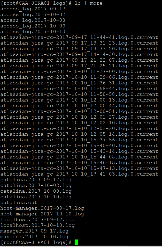

Ilai Schechter
October 10, 2017
Hey, cant see that log - any of the below?

10-Oct-2017 22:38:09.837 INFO [main] org.apache.coyote.AbstractProtocol.stop Stopping ProtocolHandler ["http-nio-808$
10-Oct-2017 22:38:09.838 INFO [main] org.apache.coyote.AbstractProtocol.destroy Destroying ProtocolHandler ["http-ni$
Like Deleted user likes this
Gonchik Tsymzhitov
October 10, 2017
Hi!
Could you check stop scripts?
Looks like a problem with stopping jira config.
Caused by: java.net.BindException: Address already in use
As I understand service starts good, but can not stop on restart, stop command.
Could you provide jira service config from systemd?
Thanks
Cheers,
Gonchik Tsymzhitov
Gonchik Tsymzhitov
October 10, 2017
Hi!
Have  you reviewed your systemd file below this thread?
https://community.atlassian.com/t5/Questions/Instead-of-init-d-use-systemctl/qaq-p/108783
Cheers,
Gonchik Tsymzhitov
Ilai Schechter
October 10, 2017
This seems to be using Stash - i dont use this?
Ilai Schechter
October 10, 2017
Tried following this article, and everything seemed to run fine, but i still have issues :(
https://community.atlassian.com/t5/Jira-questions/jira-startup-script-in-etc-init-d-fails/qaq-p/317923
