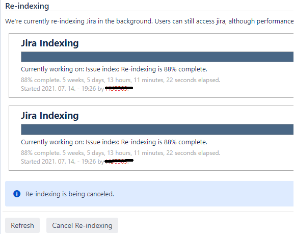

Hi everyone,
after updating Jira Software to 8.14.1 (Build number 814002), re-indexing does not finish. It is stuck at 88% for weeks now could not be canceled since it says it is being canceled. Also  for some reason, the Re-indexing menu shows 2 Jira Indexing operation.
What are the correct steps to resolve this issue?
Thanks in advance!
Peter

Hello @EOS Hungary
I think that maybe you need to increate the memory of your server.
Best regards.

After doing what you've said, everything works perfecet, indexing finished successfully!
Thanks for your help!
