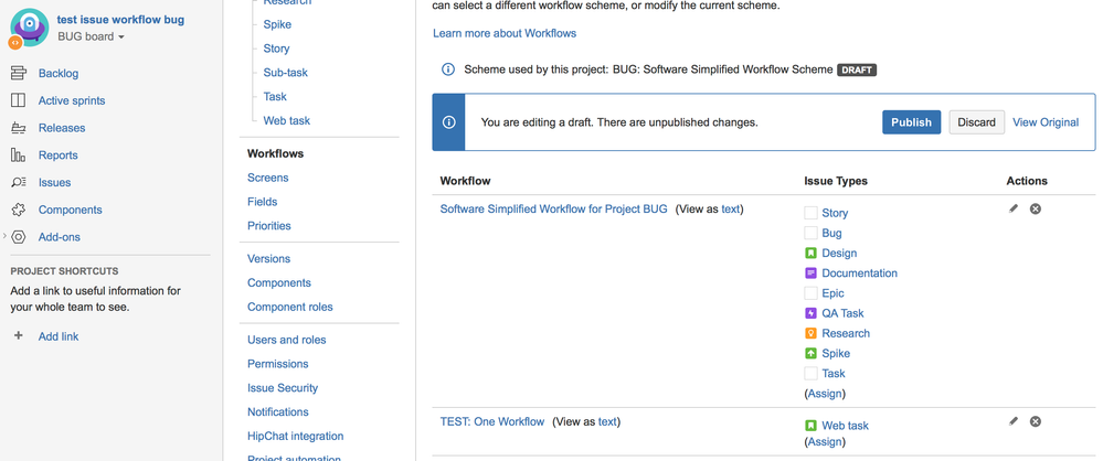

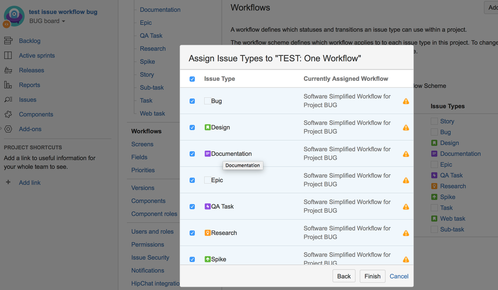

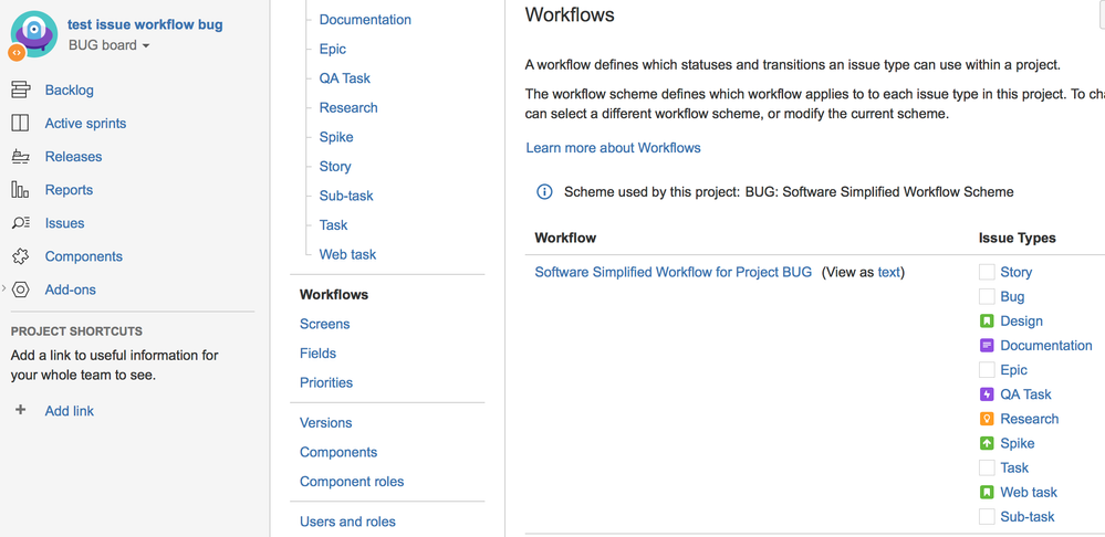

Maciej Kobiałko
January 8, 2018
Here you go, trying to assign all issues typesto new workflow results in just one issue type.
