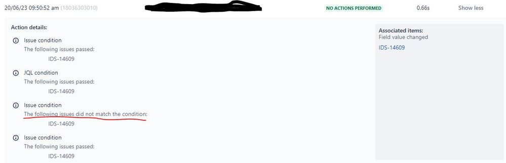

Are you sure the rule is not running, or is the rule running but encountering a condition that does not pass? Check the Audit Log to determine if the rule is running for the clone issue. You can also click on the Rule Executions field in the Details panel of the individual issue. That will pop open a panel that shows you a history of the rules that have executed against that issue.

Thank you, I had looked at the audit log before but then took a deeper dive into it, realized it is more powerful than I first thought, and it lead me to the solution.

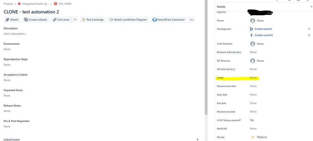

The cloned task has a label that exists that is created by the automation. If the label does not exist the automation can run. I removed the label and try to run the automation but it does not run. The audit log says it failed because the label exists, but the label is not there.

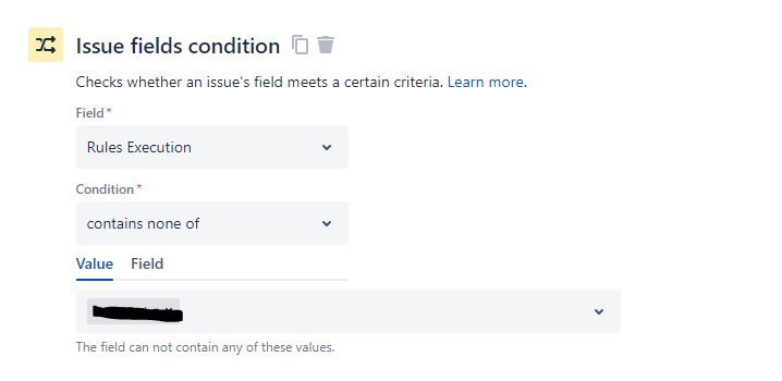

2nd snippet: has the label that if exists will not let the sub-tasks be created. But 3rd picture shows the issue we are trying to run execution of automation: the label field is empty.
Will keep double checking this.

It is looking for a rules execution in the cloned items that equals TeamTasks as per snippet 2 (middle)  I was reading too quickly.
How do you delete the Rules Execution Swat tasks from an issue?
Chris Covert
June 20, 2023
I figured it out:
Someone created a new labels based custom field called RulesExecutions
I made it visible on all issues and now people just make sure cloned issues have the label deleted before running the automation.
