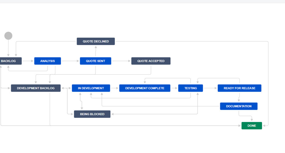

Attached is the complete sprint and workflow for the project.

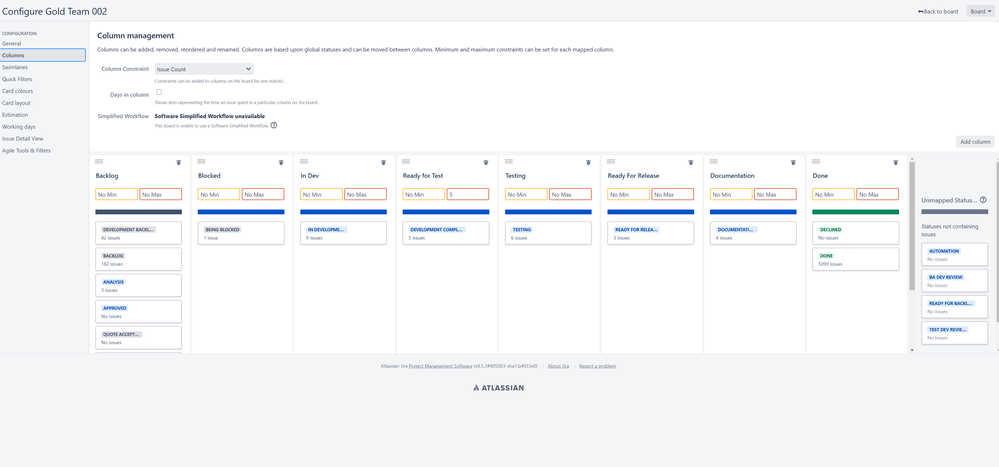

now what we need to inspect is the status to field mappings for your board not the workflow itself. Can you go to Board settings - columns and take a full screenshot? It may be that “Done” status has been mapped to “Documentation” column.

Below is what you've asked for- waiting for your expert advise :)

Below is what you've asked for- please give your expert advise :)
The mapping seems ok. Can you show an example of where a done is not in the Done column? Are you setting the resolution when moving to Done and Declined? Also, why do you have a Declined status as it is not showing in your workflow image. Possibly, there are multiple workflows involved here?

workflows are found here - project settings > workflows. All workflows will be shown there associated with issuetypes.
