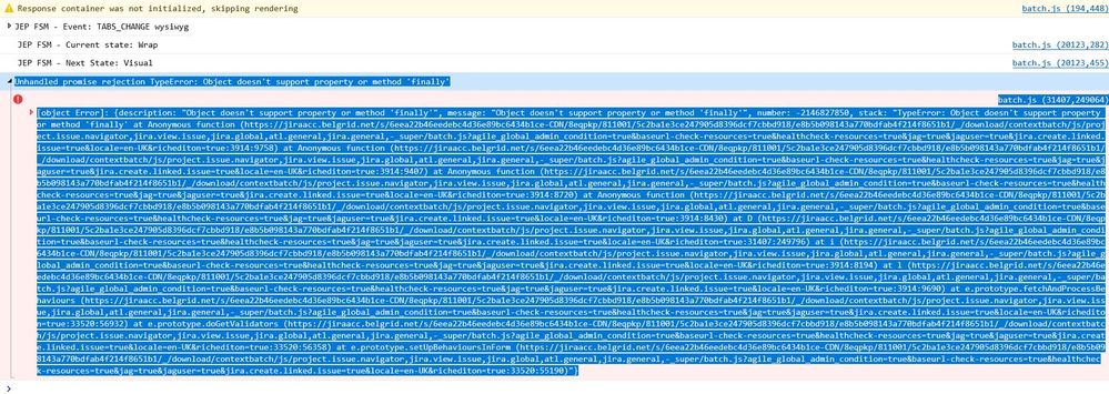

Thanks for your answer.
Indeed browsing takes place from laptop/PC.
But I think something must be different with this jira instance because we see this error  and we don't see that on our other Jira instance...so maybe you could shed your light on this  ?
[object Error]: {description: "Object doesn't support property or method 'finally'", message: "Object doesn't support property or method 'finally'", number: -2146827850, stack: "TypeError: Object doesn't support property or method 'finally' at Anonymous function (https://jiraacc.belgrid.net/s/6eea22b46eedebc4d36e89bc6434b1ce-CDN/8eqpkp/811001/5c2ba1e3ce247905d8396dcf7cbbd918/e8b5b098143a770bdfab4f214f8651b1/_/download/contextbatch/js/project.issue.navigator,jira.view.issue,jira.global,atl.general,jira.general,-_super/batch.js?agile_global_admin_condition=true&baseurl-check-resources=true&healthcheck-resources=true&jag=true&jaguser=true&jira.create.linked.issue=true&locale=en-UK&richediton=true:3914:9758) at Anonymous function (https://jiraacc.belgrid.net/s/6eea22b46eedebc4d36e89bc6434b1ce-CDN/8eqpkp/811001/5c2ba1e3ce247905d8396dcf7cbbd918/e8b5b098143a770bdfab4f214f8651b1/_/download/contextbatch/js/project.issue.navigator,jira.view.issue,jira.global,atl.general,jira.general,-_super/batch.js?agile_global_admin_condition=true&baseurl-check-resources=true&healthcheck-resources=true&jag=true&jaguser=true&jira.create.linked.issue=true&locale=en-UK&richediton=true:3914:9407) at Anonymous function (https://jiraacc.belgrid.net/s/6eea22b46eedebc4d36e89bc6434b1ce-CDN/8eqpkp/811001/5c2ba1e3ce247905d8396dcf7cbbd918/e8b5b098143a770bdfab4f214f8651b1/_/download/contextbatch/js/project.issue.navigator,jira.view.issue,jira.global,atl.general,jira.general,-_super/batch.js?agile_global_admin_condition=true&baseurl-check-resources=true&healthcheck-resources=true&jag=true&jaguser=true&jira.create.linked.issue=true&locale=en-UK&richediton=true:3914:8720) at Anonymous function (https://jiraacc.belgrid.net/s/6eea22b46eedebc4d36e89bc6434b1ce-CDN/8eqpkp/811001/5c2ba1e3ce247905d8396dcf7cbbd918/e8b5b098143a770bdfab4f214f8651b1/_/download/contextbatch/js/project.issue.navigator,jira.view.issue,jira.global,atl.general,jira.general,-_super/batch.js?agile_global_admin_condition=true&baseurl-check-resources=true&healthcheck-resources=true&jag=true&jaguser=true&jira.create.linked.issue=true&locale=en-UK&richediton=true:3914:8430) at D (https://jiraacc.belgrid.net/s/6eea22b46eedebc4d36e89bc6434b1ce-CDN/8eqpkp/811001/5c2ba1e3ce247905d8396dcf7cbbd918/e8b5b098143a770bdfab4f214f8651b1/_/download/contextbatch/js/project.issue.navigator,jira.view.issue,jira.global,atl.general,jira.general,-_super/batch.js?agile_global_admin_condition=true&baseurl-check-resources=true&healthcheck-resources=true&jag=true&jaguser=true&jira.create.linked.issue=true&locale=en-UK&richediton=true:31407:249796) at i (https://jiraacc.belgrid.net/s/6eea22b46eedebc4d36e89bc6434b1ce-CDN/8eqpkp/811001/5c2ba1e3ce247905d8396dcf7cbbd918/e8b5b098143a770bdfab4f214f8651b1/_/download/contextbatch/js/project.issue.navigator,jira.view.issue,jira.global,atl.general,jira.general,-_super/batch.js?agile_global_admin_condition=true&baseurl-check-resources=true&healthcheck-resources=true&jag=true&jaguser=true&jira.create.linked.issue=true&locale=en-UK&richediton=true:3914:8194) at l (https://jiraacc.belgrid.net/s/6eea22b46eedebc4d36e89bc6434b1ce-CDN/8eqpkp/811001/5c2ba1e3ce247905d8396dcf7cbbd918/e8b5b098143a770bdfab4f214f8651b1/_/download/contextbatch/js/project.issue.navigator,jira.view.issue,jira.global,atl.general,jira.general,-_super/batch.js?agile_global_admin_condition=true&baseurl-check-resources=true&healthcheck-resources=true&jag=true&jaguser=true&jira.create.linked.issue=true&locale=en-UK&richediton=true:3914:9690) at e.prototype.fetchAndProcessBehaviours (https://jiraacc.belgrid.net/s/6eea22b46eedebc4d36e89bc6434b1ce-CDN/8eqpkp/811001/5c2ba1e3ce247905d8396dcf7cbbd918/e8b5b098143a770bdfab4f214f8651b1/_/download/contextbatch/js/project.issue.navigator,jira.view.issue,jira.global,atl.general,jira.general,-_super/batch.js?agile_global_admin_condition=true&baseurl-check-resources=true&healthcheck-resources=true&jag=true&jaguser=true&jira.create.linked.issue=true&locale=en-UK&richediton=true:33520:56932) at e.prototype.doGetValidators (https://jiraacc.belgrid.net/s/6eea22b46eedebc4d36e89bc6434b1ce-CDN/8eqpkp/811001/5c2ba1e3ce247905d8396dcf7cbbd918/e8b5b098143a770bdfab4f214f8651b1/_/download/contextbatch/js/project.issue.navigator,jira.view.issue,jira.global,atl.general,jira.general,-_super/batch.js?agile_global_admin_condition=true&baseurl-check-resources=true&healthcheck-resources=true&jag=true&jaguser=true&jira.create.linked.issue=true&locale=en-UK&richediton=true:33520:56358) at e.prototype.setUpBehavioursInForm (https://jiraacc.belgrid.net/s/6eea22b46eedebc4d36e89bc6434b1ce-CDN/8eqpkp/811001/5c2ba1e3ce247905d8396dcf7cbbd918/e8b5b098143a770bdfab4f214f8651b1/_/download/contextbatch/js/project.issue.navigator,jira.view.issue,jira.global,atl.general,jira.general,-_super/batch.js?agile_global_admin_condition=true&baseurl-check-resources=true&healthcheck-resources=true&jag=true&jaguser=true&jira.create.linked.issue=true&locale=en-UK&richediton=true:33520:55190)"}
Thanks in advance
Kind regards
Geert

From the outside it is very hard to catch. Earlier you mentioned it is (only?) happening with Dynamic Forms - at least for the Microsoft browsers.
Probably if this is correctly understood the best would be to interview their support if they have spotted like this in the past.

Well, that's what we first thought. But now it seems that it is the case once you try to make a transition on any random issue of any random project. The weird thing is that,  when you first logon to that Jira instance you can create issues but from the moment you initiate a transition nothing seems to work anymore because of the above error.
One bullet left. We have a similar test instance (same configuration) but without the dynamic forms installed yet and working correctly.  So we could :
- just install dynamic forms on that instance
- check if everything is working correctly
- if not : ??
- if yes, add a dynamic forms custom field and define project that makes use of it
- again check if everything is still working correctly
To be continued I would say.

As long as everything is working correctly without the Dynamic Forms App I would concentrate on this one.
Not to exclude that it is somehow specific to your instance but this is something the vendor should work out with out.
The most important difference will be if the problems arise also without activated Apps in cases like this. If all is fine without Apps I would always concentrate on debugging the App installation (most times together with the vendor).
