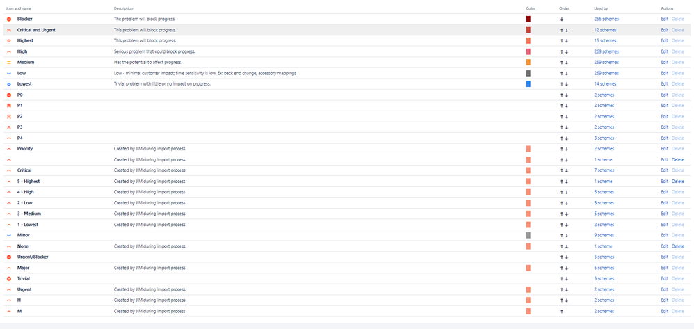

Hi @Ravikanth I believe this is the same for Data Center, if you are the system administrator, look under Settings (the gear) / Issues and then look under the Priorities section and select 'Priorities'.  This should list the priorities as well as their rank.  Is this listed as you expect?  If not, you can change that here to get the priorities to sort how you would like them.

Hi @Dan Breyen @Matthias Gaiser _K15t_ , Thanks for the quick response, Yes I am the system administrator, please see below screen shot we follow the same priority.

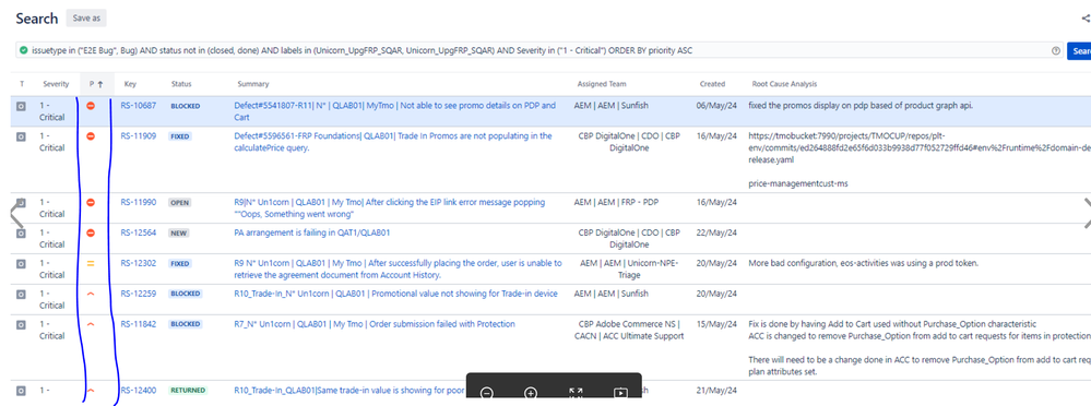

I have set it as required "Blocker > High> Medium> low"., but still when we query with below JQL query
issuetype in ("E2E Bug", Bug) AND status not in (closed, done) AND labels in (Unicorn_UpgFRP_SQAR, Unicorn_UpgFRP_SQAR) AND Severity in ("1 - Critical") ORDER BY priority ASC
