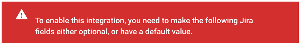

I got the error says "To enable this integration, you need to make the following Jira fields either optional, or have a default value."Screen Shot 2019-10-28 at 8.53.21 am.png
We have a required custom filed (component) but no default value and we don't want to set a default value.
I already emailed Firebase support, seems like they can not do anything.
Is there any other ways to create a bug issue automatically with custom field (component = Android)

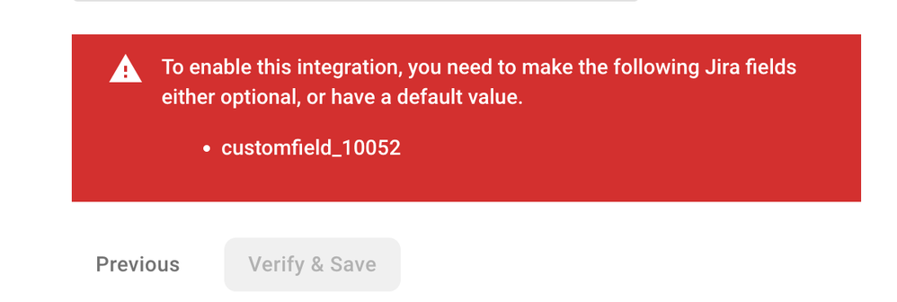

@Mathew Sommers I'm facing the same error but the field that causes an error is not present in my Jira project. Could you please help here?

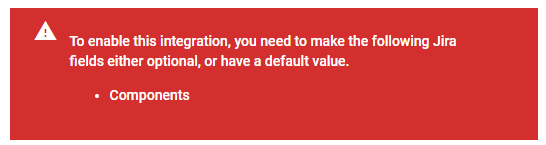

When I try to set up the integration with Jira in Firebase, I fill all the fields needed (username, Jira project link, Token) and it shows the following error :
  • Components
  • Platform

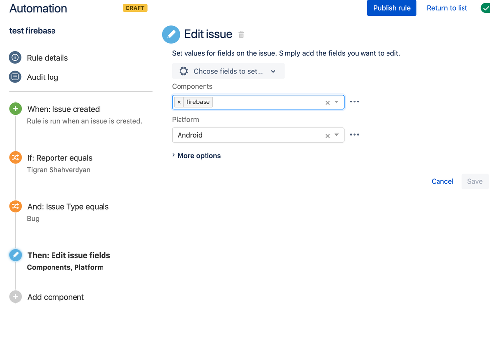

Ok. thank you, one more question, Can you check the rightness of the screenshot I've sent you?Screen Shot 2020-05-05 at 6.48.01 PM.png
Like Ekaterina Basova likes this
Mathew Sommers
May 5, 2020
Looks reasonable.  One thing we did was to use a non-regular user to link in with firebase, that way when triggering on the user, it did not impact a regular user.  In your situation, by that rule, any time you create an issue of type bug, the issue will be automatically update Component and Platform.

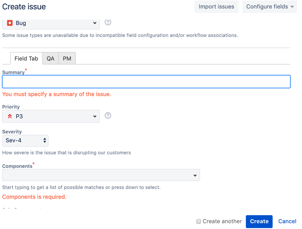

I get the same error message as @Yannick Biet and @Kelly Wang .Thanks @Tigran Shahverdyan  and @Mathew Sommers for the suggestion to use Automation.  But wouldn't the automation only execute AFTER the Jira ticket is created and not DURING?  When we create a Jira ticket, the "Component" field must be filled in before it can be created.  I did create an Automation rule to update the "Component" field to my desired option and it does update, but only after I select a random Component.  See screenshots.  Any help is appreciated.Screen Shot 2020-05-20 at 8.55.15 PM.png

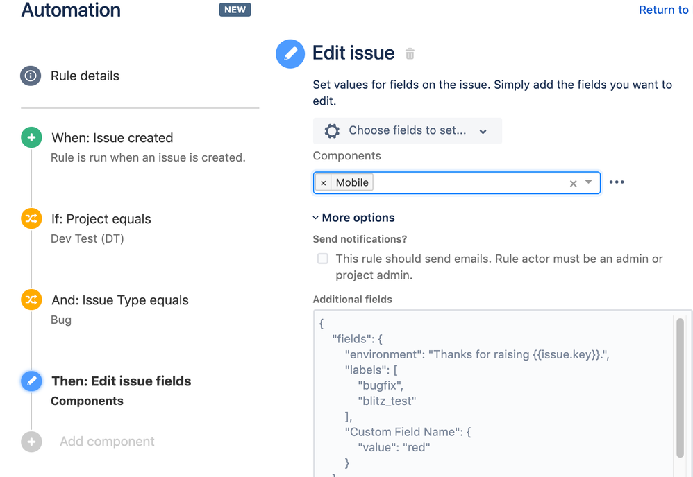

Here is the Automation I created which does update the Component field after the ticket is createdScreen Shot 2020-05-20 at 9.05.44 PM.png
