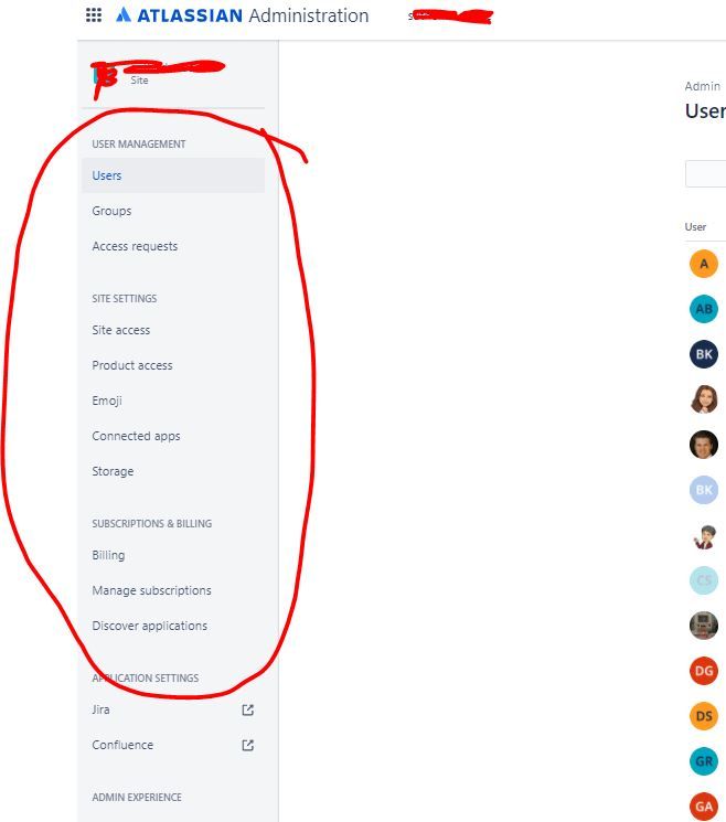

@Dave Meyer I am trying to follow the steps in the document below :
However CouldNot locate the -->User Provisioning--->Create Directory. See screenshot from my setup below.
Any ideas ?
Hi @Sujoy Majumdar ,
That screen is from the administration area for your site; however user provisioning is configured for an organization (so it can work across multiple sites). Based on your screenshot, it looks like you are not an admin for the parent organization of your site. If you have an idea who might be an admin, I would check with them to see if they see something different when they go to admin.atlassian.com
Otherwise you can contact Atlassian support and they can help you identify the admin of your organization.
