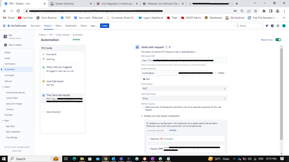

Hello Team,
I am unable to send a webhook to Jenkins server I am getting error as 403 Forbidden even after providing valid creds and details
Can you please help me how I can successfully create web hook in Jira cloud which will trigger job in Jenkins local server ?

A 403 Error usually indicates that the server doesn't support the specific request that you are sending. I don't know Jenkins, so I can't be help with the specifics. Can you check that "POST" is the correct method and that it isn't expecting a GET or a PUT?
Normally, if you have the wrong credentials, you will get a 401 error. If you have submitted an invalid URL, you will get a 404 error.

Hello @CD QA ,
Is the URL publicly available?
Be careful with URLs you paste here if they are sensitive.
I used the server and scheme and it times out.
The 403 forbidden may be a read herring, you may have whitelisted IPs / domains on the endpoint so my test is not good as I do not have enough information.  Heads up with pasting identifiable things in your questions. I would propose replacing the image you have above

@CD QAthanks for blocking out the details :)

Hi
Thank you.
Regarding whitelisting IP addresses, I believe it can be helpful. However, I'm not entirely sure how we can whitelist IPs or domains in the local Jenkins server.
