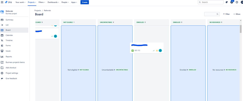

A few weeks ago I removed a particular status ("Enrolled") from our project workflow, however it remained on the project board. One is not able to transition issues into the status. When one clicks on or tries to drag that status column on the board then Jira freezes. One has to then reload the page.

- The first shows that one is unable to transition issues to the old/problematic "Enrolled" status column. This can be seen by the fact that it is greyed out whereas the column representing the new "Enrolled" status I added is blue.

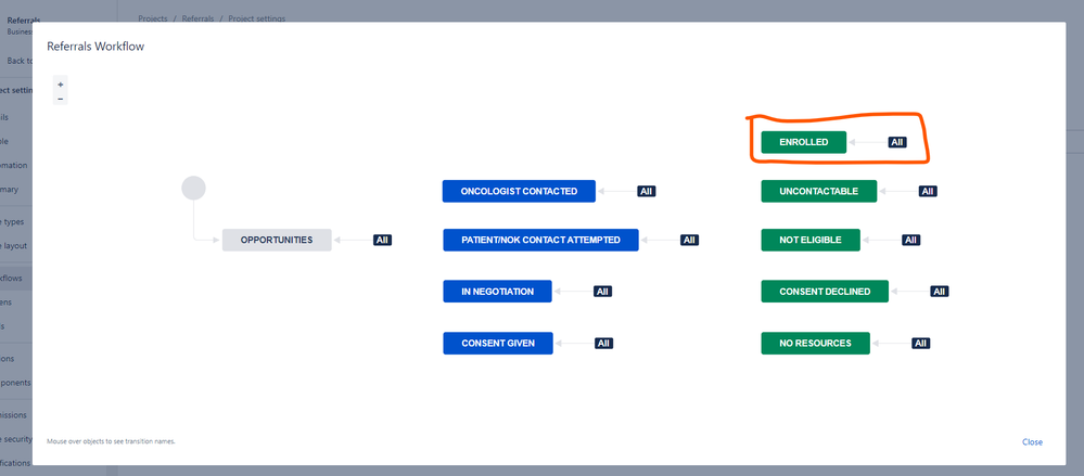

- The second shows the current project workflow. There is only one "Enrolled" status in the workflow. After I first removed the original "Enrolled" status and before I recently added it back, there was no "Enrolled" status in the workflow.

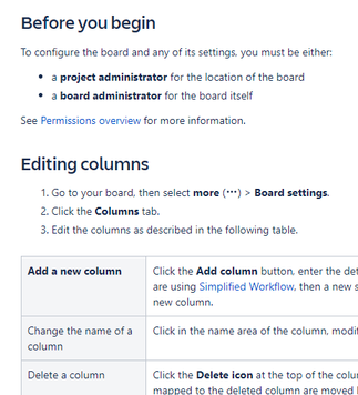

According to that documentation on configuring columns on my board, when I click on the more (•••) button, the option of Board settings should be available. See screenshot from the documentation:

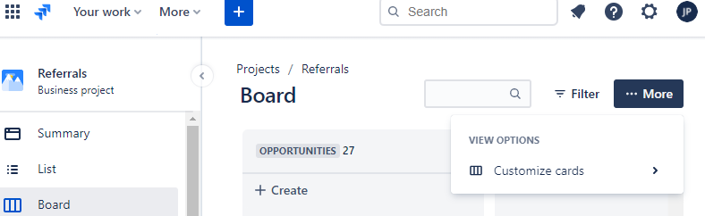

However it is not for me. See screenshots below:

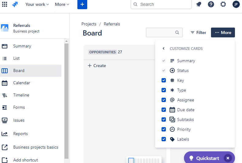

Screenshot when I click on the Customize cards button:
Do you perhaps have an idea why the option of Board settings is not coming up for me?

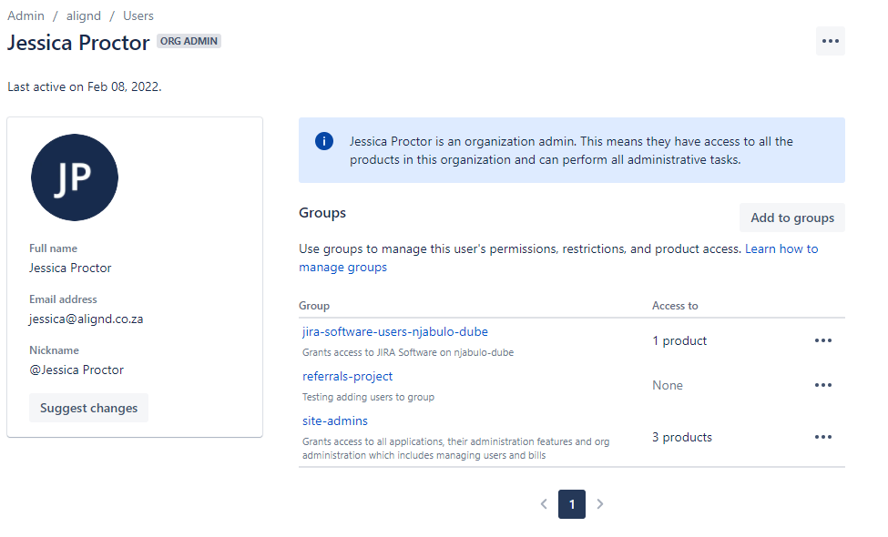

I am the project administrator so I don't think it has to do with permissions. See screenshot below:
