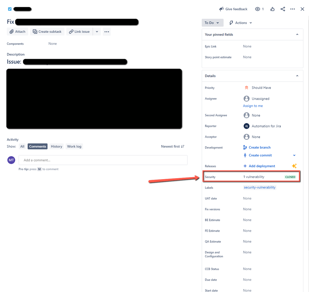

We have integrated Snyk into the new Jira Security feature. Now Snyk alerts flow in, and we have an automation to create an issue when a vulnerability is found. So far so good.
Now we see that vulnerabilities are being closed automatically by Snyk as we remediate issues, and this closed status is being detected by the Jira issue in the Security field on the right side (see screenshot).
My question: is there a way to access this new Security field so that I can automatically close this issue?

Hey @Bill Sheboy I did use the api to get the full json structure of an issue, and I see that the security field does not exist. So it looks like we do not have access to this data. Hope they roll out more automations for the security feature šŸ¤ž
