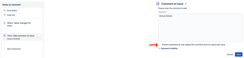

I've tried it myself right now, so what you want to do is a two step automation like this: Screenshot 2023-02-17 at 12.59.16.png
  1. When: Value changes for Field [Notes]
  2. Then Add comment.
    1. You can use only {{issue.[Notes]}} and it will duplicate the current content of the Notes field, whether if the issue was just created or changed at a later date
  3. Remember to uncheck the "Prevent duplicates" box, or else it can only run once per issue.

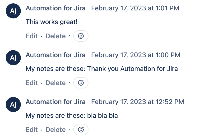

That's got it working, thanks Tobias!
