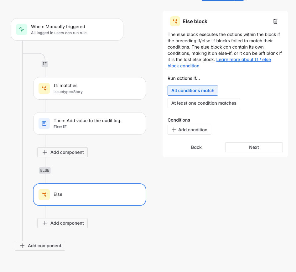

Shi
July 17, 2025
That’s strange I am not able to see more than one else in an IF branch - so using IF or else
gives me only one else and this is my main problem I wonder if this is the license am using?
Like John Funk likes this
Trudy Claspill
July 17, 2025
No, there is no difference in this functionality based on the license.
Can you provide a screen image of what you see?
Shi
July 20, 2025
Screenshot 2025-07-21 151228.pngScreenshot 2025-07-21 151239.pngthis is all I can see
Shi
July 20, 2025
FYI am on the premium plan
so not sure if that feature is only on enterprise plan
Shi
July 20, 2025
I tried to add same structure manually could not find a way but - when I ask the jira AI to do it by if else if then else than that worked
Like Trudy Claspill likes this

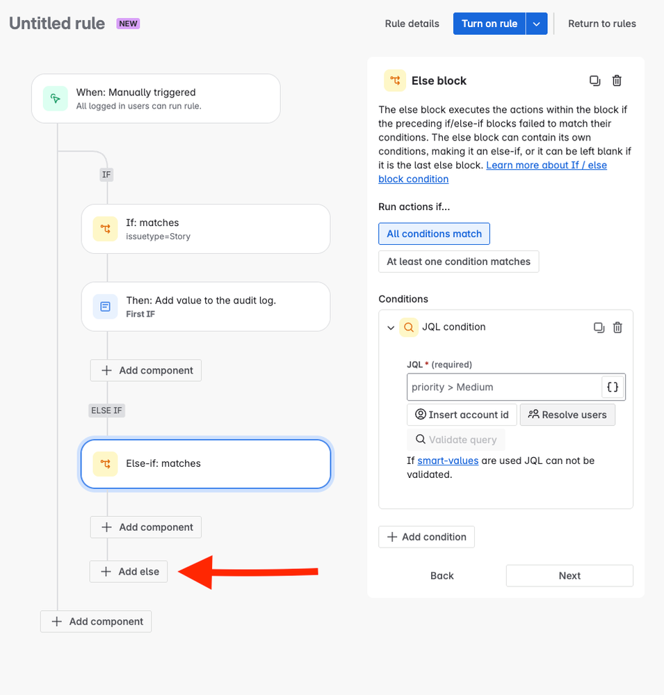

Trudy Claspill
July 21, 2025

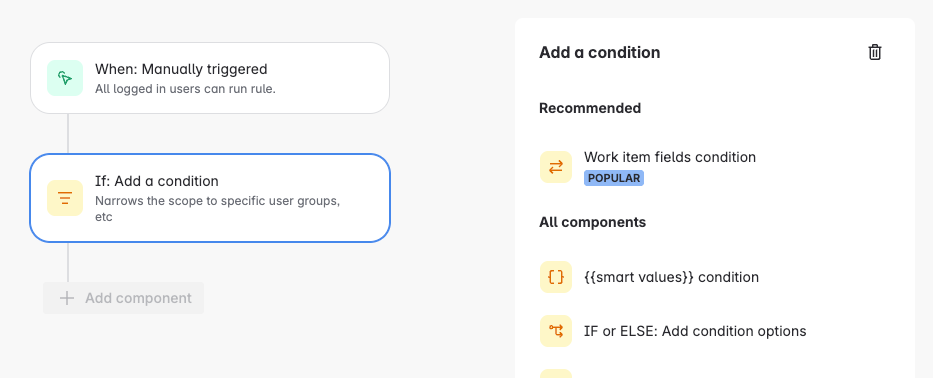

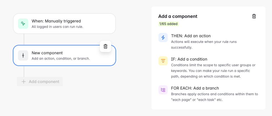

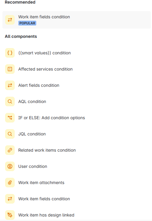

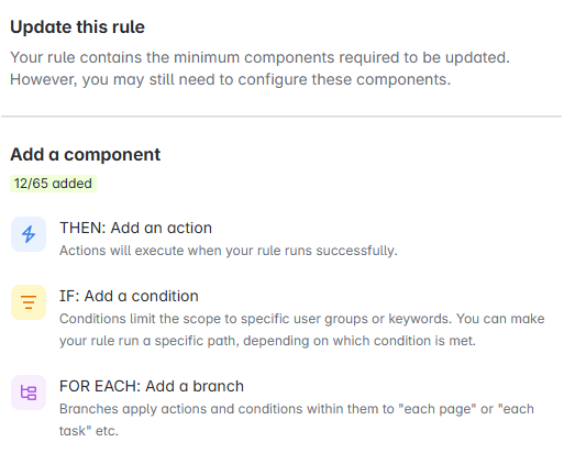

The manual way:
At the point where you want to and the If-ElseIf-ElseIf-Else:
Click Add component
Click IF: Add a condition
Click IF or ELSE: Add condition options
Add a Condition

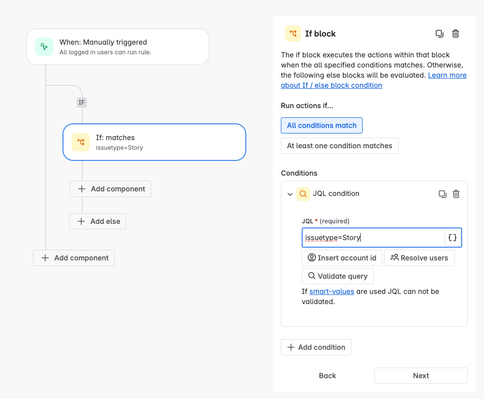

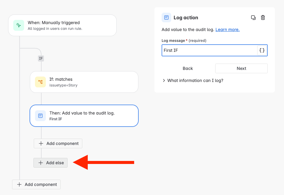

Click the Add Component button directly below that IF in the diagram on the left and add an action
Click the Add Else button below that.

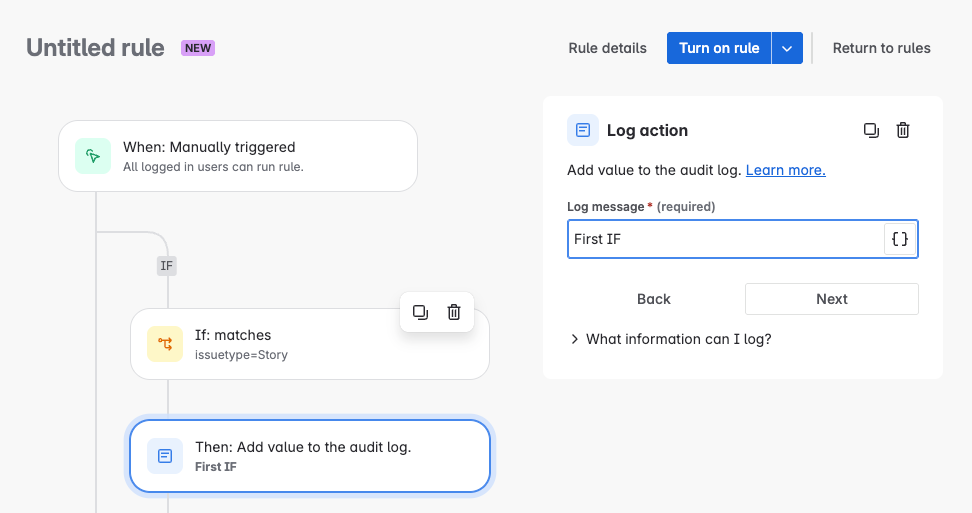

Click the Add Condition button in the dialog on the left, then select a condition. Notice that a new Add Else button appears in the diagram on the left.

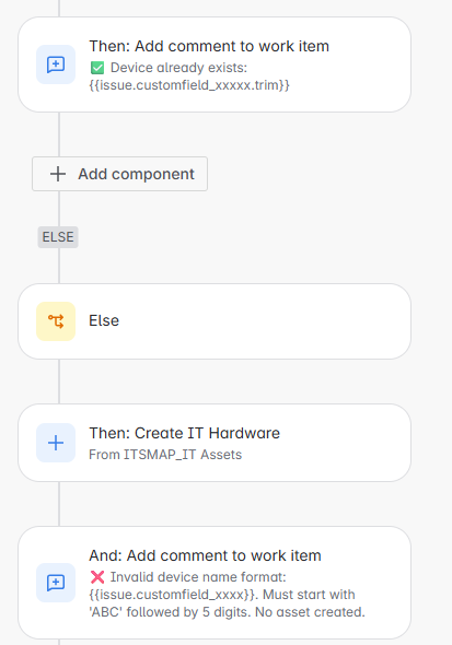

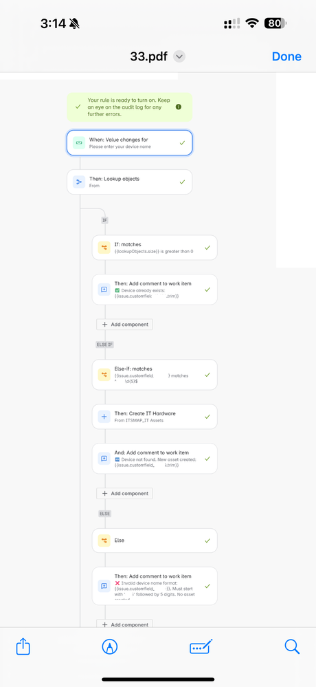

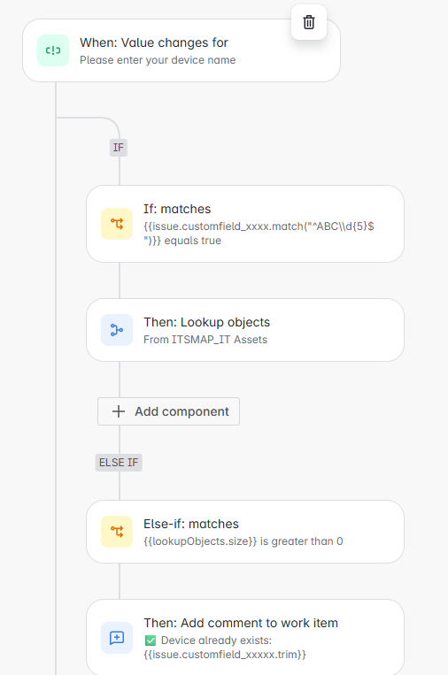

Shi
July 21, 2025
This clears a lot
sorry for the delay
I have attached a screenshot of the layout iv done but the automation stills fails as the last else still creating an object in jira asset regardless what is the input so the idea that if if I add anything other than ABC followed by 6 numbers I only get that comment device name is wrong - and nothing is added in the asset , but if the user enters a correct device name then automation should lookup this device if it match I get comment saying it match and it won’t add a new device name
in case the device name entered correct and it does not match what’s in the asset sheet the automation then should add a new device name and give me that comment that device name was added successfully
so here am using only one custom field where the user enters the device name
Shi
July 21, 2025
Thanks Trudy
your lay out was actually perfect
so first trigger value change with custom field
then
IF
match regex
lookup in asset
then
else if
Lookup object greater than 0
then add comment device already exists
then
else
then create object in schema
then comment wrong device name
that worked perfectly

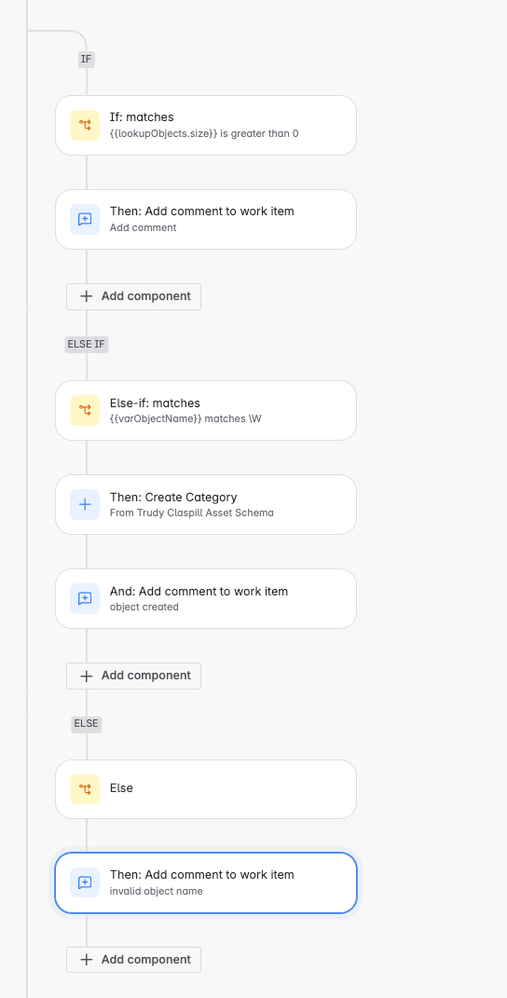

Trudy Claspill
July 21, 2025
Hello @Shi

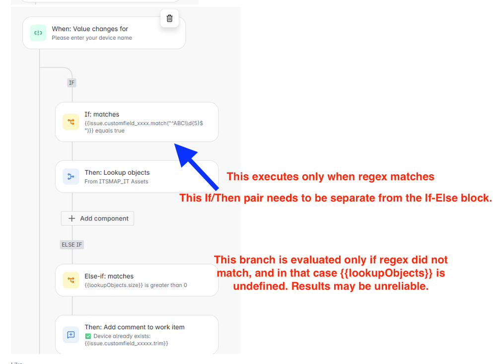

Just to make sure there has not been a misunderstanding, can you provide screen images that show your entire rule from the beginning? The images you showed in you next to last reply and the text you put in your last reply indicate a flow that does not match my recommendation, and I am concerned that it will not work as you intend.
I think the "If match regex then lookup objects" should not be part of the IF-Else block.
Shi
July 21, 2025

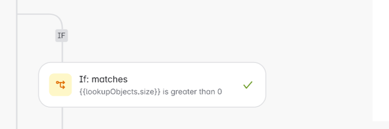

Trudy Claspill
July 22, 2025
Thank you @Shi . The structure of your rule looks correct.
I suggest changing one last thing. In this comparison:
Instead of {{lookupObjects.size}} I recommend that you use
{{lookupObjects.size|0}}
That says if lookupObjects.size is null then use "0" for the comparison. Comparisons to null can have unexpected results.

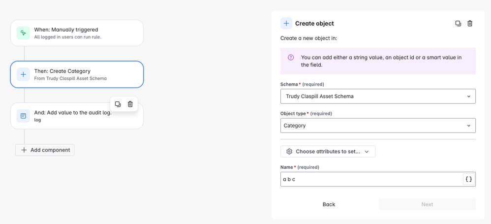

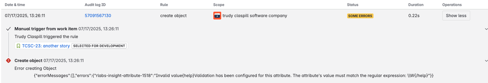

Trudy Claspill
July 17, 2025
@arielei
That won't work.
When the validation fails and the object can't be created, that will cause an error to occur in the rule and none of the steps after that will be executed.Screenshot 2025-07-17 at 1.27.58 PM.pngScreenshot 2025-07-17 at 1.27.43 PM.png
