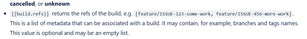

Basically, I have automation rule to which is triggered when "Build is successful" . Now I am trying to read all the paramters related to {{build}}. So {{build.refs}} return branch information.
As mentioned in this link - https://support.atlassian.com/cloud-automation/docs/jira-smart-values-development/
Earlier it was returning the value, but not its returning empty.
I would like to know the reason. Is there alternative way.?

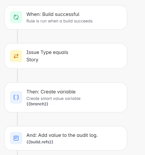

Snippet of Automation rule

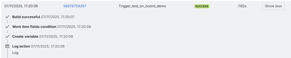

Audit log -

Hi @shriya
Please post an images of the following to provide context for what you are observing:
  • your complete rule in a single image for continuity,
  • the action where you are using that smart value, and
  • the audit log details showing the rule execution.
Until we see that...
I recall some of the smart values (including development ones) are loaded just-in-time when needed.  Thus, depending upon how your rule is using the value, it may not be available fast enough for usage.
A workaround for this is to first store the value using Create Variable and then using the variable later in the rule.  This will force the full evaluation of the smart value before it is needed, preventing any timing problems.

And as noted in the documentation, because the information is optional for the branch, that specific smart value for the refs may be empty.  Have you looked in your source control tool to confirm if it indeed does contain information?
