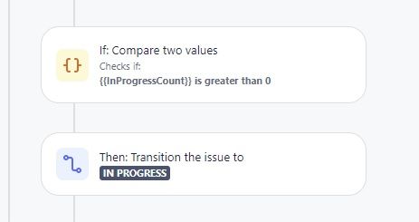

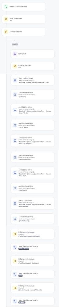

I'll look at the other Epic scenarios and other actions performed on the tasks apart from transitioning statuses at later date.  Also worth noting we don't use Stories and only the statuses of Tasks need to effect the Epic. I have had an attempt at a new rule, but its very messy, especially as I cannot find a "If/then/Else" component to use, only IF. Can the below be done better ?

The if / else condition cannot be used inside of a branch on Parent.  And so the way you wrote your rule will stop as soon as it fails a condition.  That can be inverted, with the branch inside of the conditions...
The rule structure I was suggesting is more like this, using create variable, math expressions, and list iteration:
  • trigger: issue transitioned
  • condition: issue type equals Task
  • condition: issue Parent exists
  • action: use lookup issues to gather the issues in the same parent as the trigger issue with
    • parent={{triggerIssue.parent.key}} AND issueType = Task
  • action: create a variable to count the issues found
    • name: varTotalCount
    • smart value:
      • {{lookupIssues.size|0}}
  • action: create a variable to count the issues in "To Do"
    • name: varTodoCount
    • smart value:
      • {{#=}}0{{#lookupIssues}}{{#if(equals(status.name,"To Do"))}}+1{{/}}{{/}}{{/}}
  • ...repeat for the other counts needed
  • if / else condition
    • smart value condition:
      • first value: {{varTodoCount}}
      • condition: equals
      • second value: {{varTotalCount}}
    • branch: to parent
      • action: transition to To Do
  • else / if condition
    • repeat for the other needed checks
If you want to shorten the rule a bit, you could use a single Create Lookup Table action in place of the create variable actions:
  • action: create lookup table
    • name: tblCounts
    • row
      • key: Total
      • value: {{lookupIssues.size|0}}
    • row
      • key: ToDo
      • value: {{#=}}0{{#lookupIssues}}{{#if(equals(status.name,"To Do"))}}+1{{/}}{{/}}{{/}}
    • ...add a row for each count
  • to perform the comparisons, lookup the values from the table
      • first value: {{tblCounts.get("ToDo")}}
      • condition: equals
      • second value: {{tblCounts.get("Total")}}

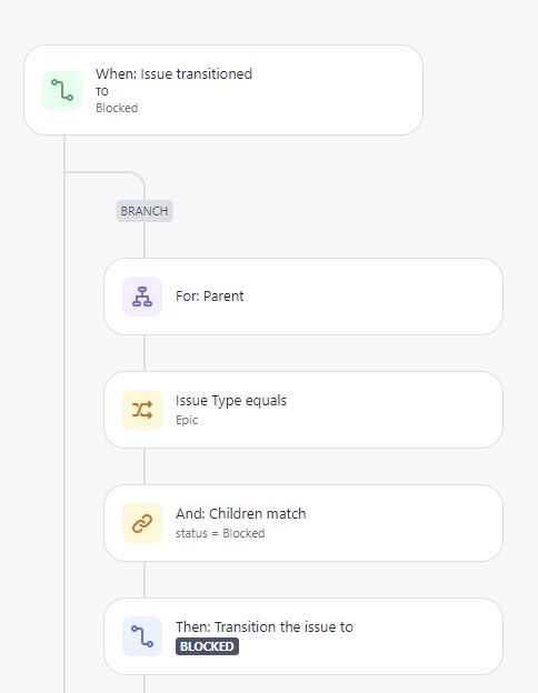

When asking for help with an Automation rule, it will help us help you if you provide screen images showing your entire Automation rule and the details of each step. It is also helpful if you explain what is not work or the part with which you need help. If the rule is running and not producing the expected results, include the output from the rule execution log, and tell us what results you expect vs. what you actually get.
In this scenario it sounds like you may also have multiple rules running to change the Epic status, so please provide screen images for all the rules that you are using to change the Epic status.
Julia
September 23, 2024
I have one of these each for To Do, Blocked & Test, but they move the Epic if ALL the children are the matching status (and they work fine). The one I am after is to move the Epic to In Progress if the children are multiple different statuses so it shouldn't clash with these three rules. (Moving to Done is required to be done manually as it is linked to another process)
