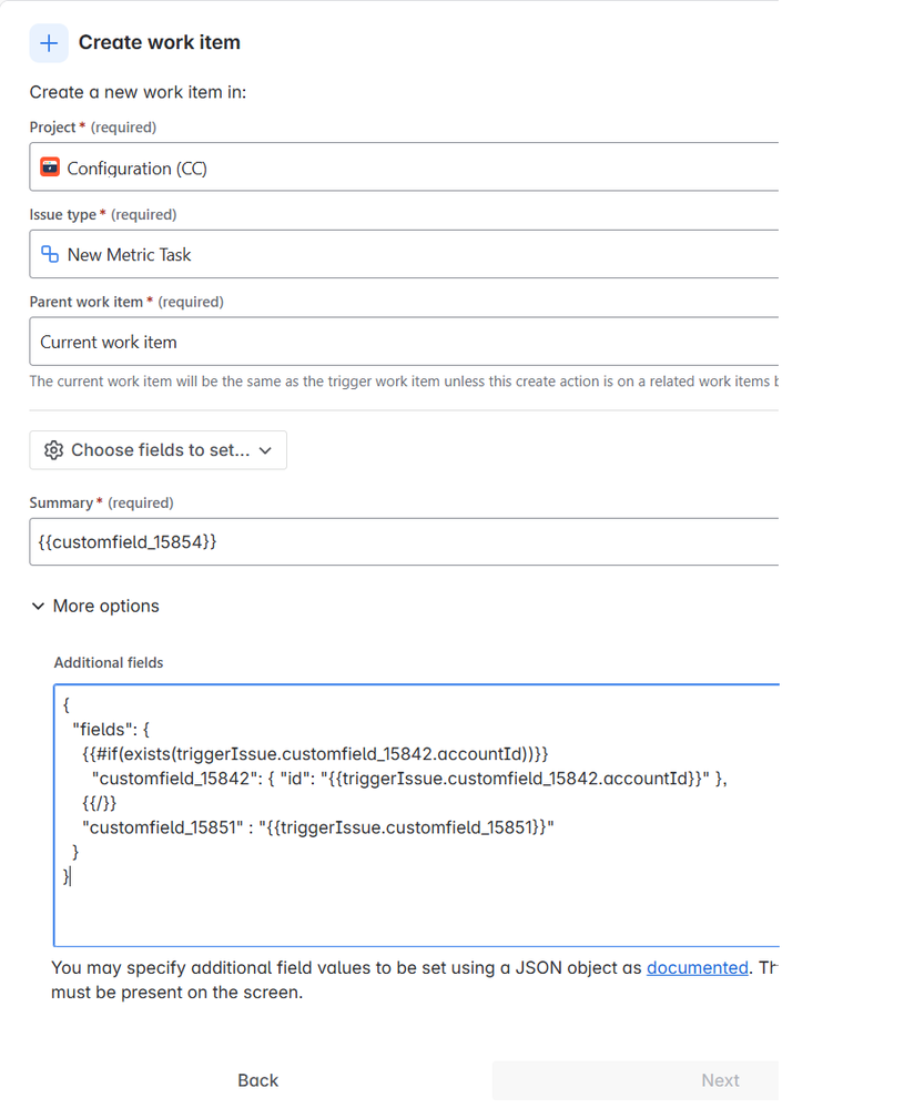

Finally, please show an image of your entire Create Work Item action.  It is possible you are selecting overlapping options and that is causing the error.  For example, by selecting the field from the dropdown list AND trying to set it with JSON.

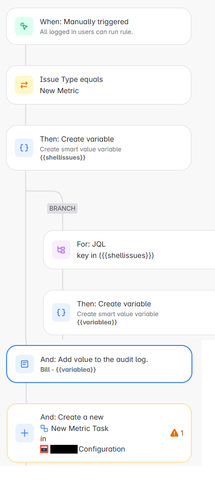

philip_song
June 23, 2025
Hi @Bill Sheboy
This is back to not working in a very confusing manner :)
Here is the logic of the complete automation:
The text I'm putting into the variable is this:
{ "fields": {
{{#if(exists(triggerIssue.customfield_15850.accountId))}}
"customfield_15850": { "id": "{{triggerIssue.customfield_15850.accountId}}" },
"customfield_15851" : "{{triggerIssue.customfield_15851}}" } }

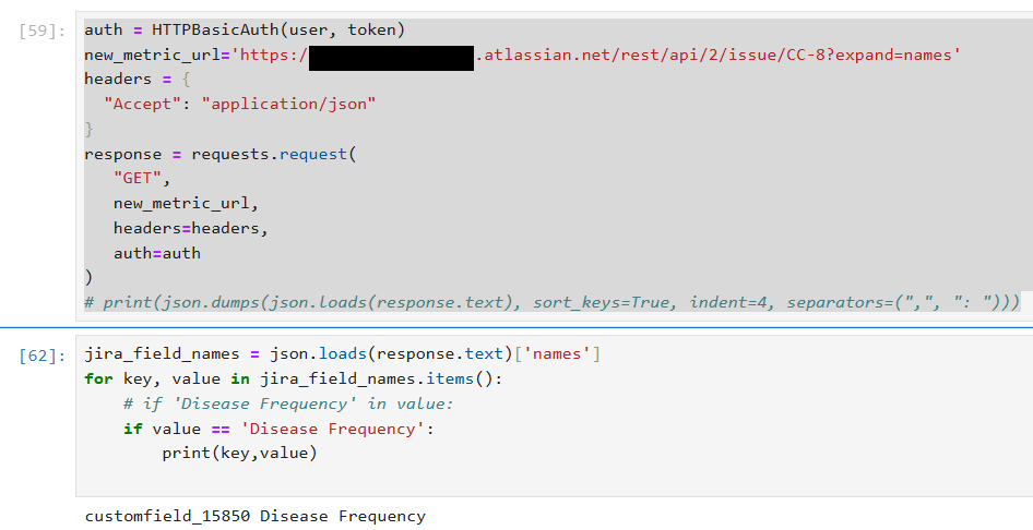

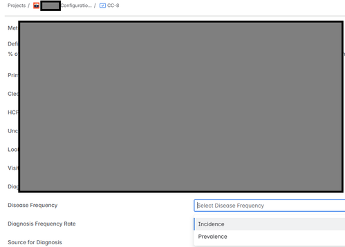

This field customfield_15850 I'm confirming is the field I think it is by using the python jira api (I don't think I otherwise have access to figure out what the field is in the jira browser)
^ Here I'm confirming that in issue CC-8, the customfield_15850 field corresponds to `Disease Frequency` which is indeed a dropdown

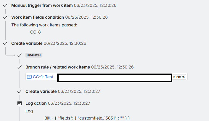

Finally, when I look into the log itself, it just shows an empty field:
Hope this is clear enough!
Bill Sheboy
June 23, 2025

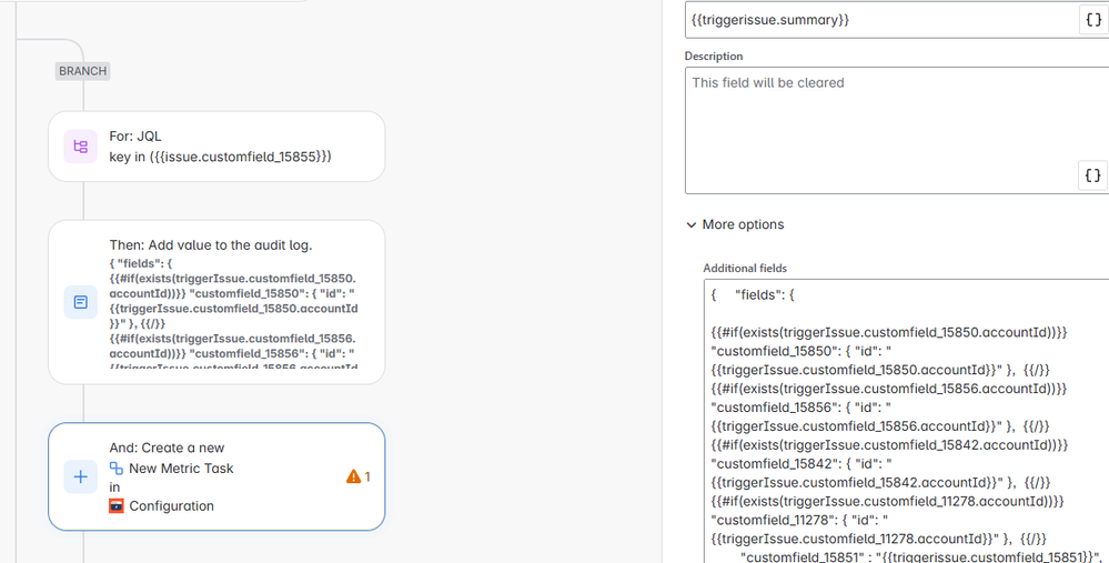

Short answer: if you are trying to gather the custom field's data for a set of work items, use the Lookup Work Items action to gather them with the JQL, and then create the variable based on the results.
Branches which could be over more-than-one-thing are processed in parallel and asynchronously, with no guarantee of when the branch will complete up until the last step of the rule.
And so for the rule image you show:
  • on each loop through the branch, the created variable is disposed of when it goes out of scope
  • the write to the audit log is outside of the branch and thus...
    • it will always be empty, and
    • even if the value could somehow be "accumulated", the write to the log would likely happen before the branch finishes
philip_song
June 23, 2025
The workflow is
Ticket is created -> Automation is triggered, looks up the created ticket (which it has no problems doing) -> read fields from created ticket, create new ticket.
In the event that I want to do this for multiple issues, I don't have any issues if they're created in parallel/out of order.
Are you saying that within the scope of the branch, all the triggervalues (which I intend to reflect CC-8) don't exist?
Bill Sheboy
June 23, 2025
No, I was not.  When a rule has a trigger issue, the {{triggerIssue}} smart value is available throughout the rule.
I was describing because of the type of branch you used, the created variable is not available after the branch, or even shared between loops through the branch.

  • Build the JSON before the branch as a variable, and using that variable in work item create inside the branch
  • When creating the work item, ensure each field is only set once.  That is...
    • The create and edit work item actions allow either selecting a field from the dropdown list or by using JSON
    • For the fields in your JSON expression, ensure they are not also selected from the dropdown list
    • You do not show your entire Create Work Item action so I cannot confirm this

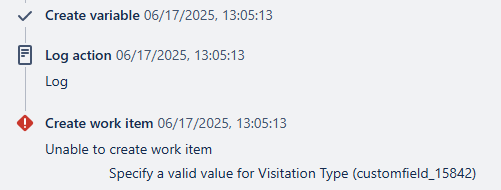

philip_song
June 17, 2025
Hi @Bill Sheboy ,

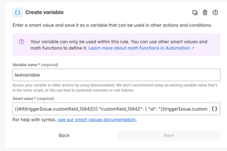

Sorry can you explain how you're meant to use the logger?
I built a variable here with the following logic:
{{#if(triggerIssue.customfield_15842)}} "customfield_15842": { "id": "{{triggerIssue.customfield_15842.accountId}}" }, {{/}}
And then used the `Log Action` component with the log message {{testvariable}}
but in the audit log, the log action simply says Log:

"customfield_15851" : "{{triggerissue.customfield_15851}}"
{{/if}}
And regarding to loggin, no need to create variable, you can only put Log Action item, before the JSON, to see what it returns. On Log Action put the same JSON, and you will see the result, what JSON is returning.
Let me know if it worked or no.
philip_song
June 18, 2025
@Gor Greyan
I see that's helpful!
I tried your block (changing {{/if}} to {{/}} because it's otherwise invalid) and now the rule runs, but the fields don't populate as expected (all fields are empty).
Gor Greyan
June 18, 2025
Dear @philip_song
Thanks for your feedback.
Could you please share log action, before the action, to see the result.
philip_song
June 18, 2025
Hi @Gor Greyan ,
This is what I put into the log:
{ "fields": { {{#if triggerIssue.customfield_15842}} "customfield_15842": { "id": "{{triggerIssue.customfield_15842.accountId}}" }{{#if triggerissue.customfield_15851}},{{/}} {{/}} {{#if triggerissue.customfield_15851}} "customfield_15851" : "{{triggerissue.customfield_15851}}" {{/}} } }
and the result from the log is:
{ "fields": { } }
Gor Greyan
June 22, 2025
Hi @philip_song
This is the cleaned up version. Please try also this one.
"fields": {
"customfield_15842": { "id": "{{triggerIssue.customfield_15842.accountId}}" }{{#if triggerIssue.customfield_15851}},{{/if}}
{{/if}}
"customfield_15851": "{{triggerIssue.customfield_15851}}"
{{/if}}
