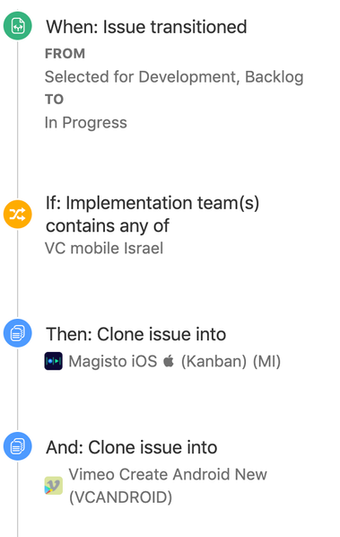

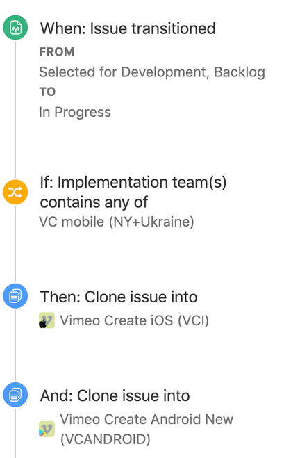

I have been using automation to create linked issues in multiple jira boards based on a custom field value. My scenario is following: one team starts working on a ticket, and once they are done with their part, other teams (multiple teams) will need to do their part accordingly.
So I have a board where the workflow starts, then at certain status, the jira automation triggers creation of linked issues in other teams boards based on Implementation team fields.
It worked fine when I just implemented it (couple of weeks ago), but now the rules just fail for some 1 or 2 out of very identical 6 rules. The only thing I could think of is potential problems when the ticket has 2 or more implementation teams selected, but it works half of the times. Very confusing.
Attaching some screenshots with my rules, happy to answer more clarifying questions.
This rule always works:

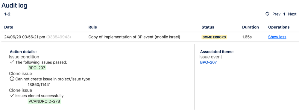

this rule fails with error: Can't create the issue in project ( I checked all permissions and such). what else could be wrong here?

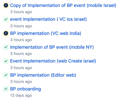

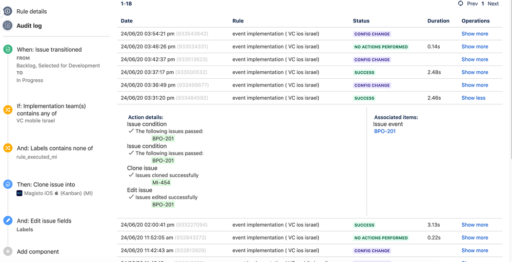

I am out of ideas honestly, cause I explained earlier that i have 6 identical rules, and 1 or 2 fail every time, while 4 -5 work. And it is not the same rules that are failing every time. here is a screenshot from earlier today.
if you see my first screenshot from this thread - the rule that was failing was called - event implementation (VC ios Israel) and it is successfully run today with no changes made since last time.

In the error from the screenshot above:
> can not create issue in project/issue type 13850/11441
13850 is the project id.
and 11441 is the issue type id.
Similar to John, I'd be curious to know if that issue type exists on the target project. You could check that in Jira's preferences, or hit the REST API https://stagingwatergood.jira-dev.com/rest/api/3/project/13850?properties=issueTypes and see of one of the listed issue type IDs is 11441.

Can you post a screenshot of the error you see in the Audit Log for the rule?

I have a different rule that was successful at creating tickets in that failing project, see attached.
I was trying out the different approach where instead of cloning twice within the same rule, I had two separate rules as an experiment. While that experiment worked for some time, the different rule (identical one) started failing.
So I am having 1 or 2 rules out of 6 fail consistently.

But it wouldn't explain why i can create tickets in that project with a different rule, but not the original one. If you see the last screenshot I attached yesterday, it is the same project that in a rule with an error.
My original rule tries to create clones in 2 projects (it does always create successfully in one of the projects (android), but fails for another (magisto ios)). I had to make a different rule that only createsa clone ticket in a magisto ios project, and that rule doesn't fail.
