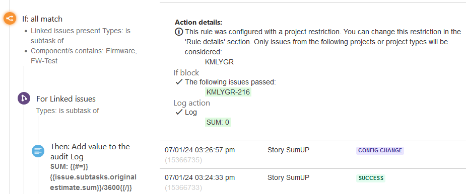

i do have parent story: And i do want to be able to sum up all time estimations from linked issues (is subtask of) to the parrent. The trigger is set up as an update for the "is subtask of" issues.
I have red about the issue.subtasks approach but it seems that it just works for subtasks. How can i trigger "is subtask of" link?

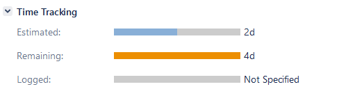

By time tracking i mean this table
Now it passes but it adds 0m into parent story
Thanks
NOTE: {{issue.subtasks.Original Estimate.sum}} has the same behaviour, it adds 0m
{{issue.issuelinks.isparettaskof.Original Estimate.sum}} , SUM: {{#=}}{{issue.issuelinks.outwardIssue.originalestimate.sum}}/1{{/}} the same
LOG:

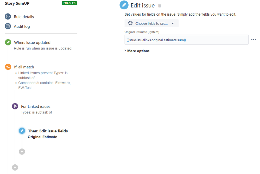

Svatopluk Blazej
January 7, 2024
So the problem was, as i suspected by selector: this is the correct selector for timetracking fields {{#=}}{{issue.issuelinks.outwardIssue.fields.timeestimate.sum}} / 3600{{/}}
Note: change the M/H/D transition (divide) according to your config.

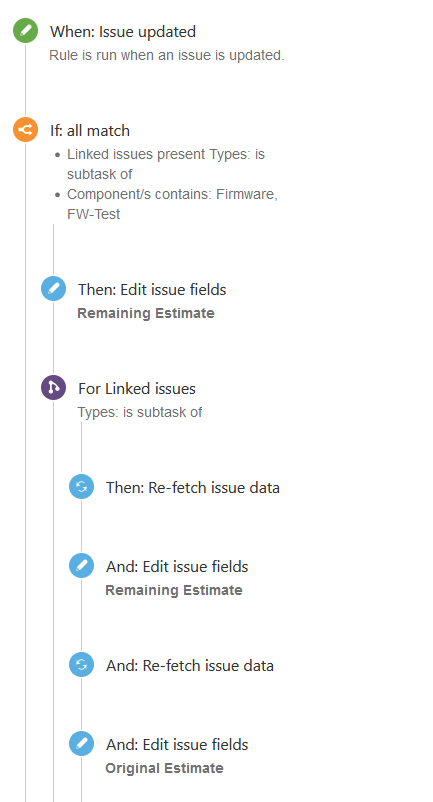

Hello, thanks, i used audit logs, to find the correct selector for fields in this tasks,
This is the final working scheme with "{{#=}}{{issue.issuelinks.outwardIssue.fields.timeestimate.sum}} / 3600{{/}}" Edit issue input
And please note that we are not using jira for logging, thats why remaining + estimated field needs to be the same
