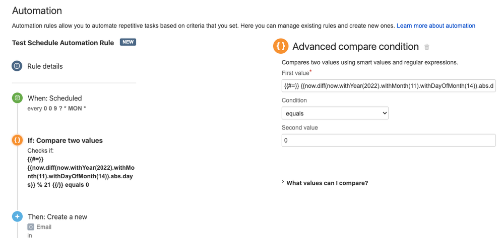

I have similar case for a rule that should run every 3 weeks on Mondays 9am. So I ended up creating a cron job that runs every Monday at 9am, however I tried to use a condition that will result true every 3 weeks from the base date you give. For example my base date is 2022-11-14 which is again Monday I've used below expression:
{{#=}} {{now.diff(now.withYear(2022).withMonth(11).withDayOfMonth(14)).abs.days}} % 21 {{/}}Above value would return zero for every 21 days (3 weeks) starting from the base date and you can let the rule do whatever action it needed. Tweaking with the numbers you can set any fixed frequency. The expression might be optimized further, but it simply runs.
And also I still don't get it why A4J for DC still does have a cloud-like fixed schedule feature, makes life easier for Jira admins ;)
Hi @Cengiz Akyildiz , where do you use the expression – it it in the subscription cron field? It doesn't seem to allow me to put curly brackets in that field.
