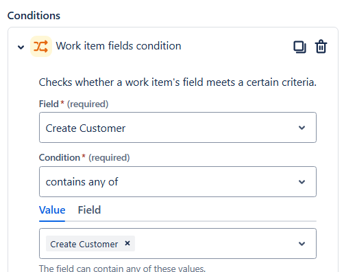

Hi @Yogesh Mude
To create a new work item when a checkbox custom field named Customer is selected during a transition to the In Progress state:
  1. Trigger: Use the Issue transitioned trigger (e.g., when the status changes to "In Progress").
  2. Condition: Add an Issue fields condition:
    • Field: Customer (your checkbox field)
    • Condition: contains
    • Value: The specific checkbox option (e.g., "Yes", "Selected", etc.).
  3. Action: Add a Create issue action to generate the new work item.
Important Note-  Since checkbox fields can have multiple selections, use "contains" rather than "equals" to check if the desired option is selected.

Yogesh Mude
July 1, 2025
@Marc -Devoteam- I checked and its not working with Field condition. you can take a look at the below attached snaps.

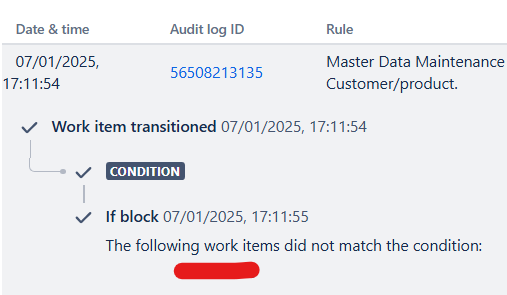

Yogesh Mude
July 1, 2025
if you see attached snps, this is the first condition that i have added and checking the field values of type check box ie. Create Cusotmer..if yes, then go ahead and do the rest action.
But the first conditions itself is failing.
