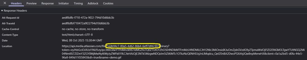

Extract the media ID from the attachment
Jira Cloud doesn’t expose the media ID via any public API, but you can retrieve it indirectly.
Call the GET /rest/api/3/attachment/content/{id} endpoint.
The Location header in the response contains a URL where the media ID appears between /file/ and /binary?.
You’ll need to parse that UUID out programmatically.
