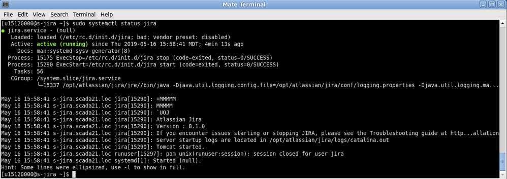

Deleted user
May 16, 2019
Did not work.
systemctl status jira show  taht process is running but it does not.
