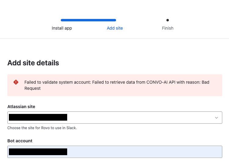

The CONVO-AI Bad Request is the Add Site step failing to validate the bot account you're designating, which fits what you said about already having done it. Rovo access is on by default, so there was no enable switch to miss here.
The bot account is where I'd look. Atlassian requires it to be a managed Atlassian account, licensed in Jira and Confluence, and specifically not a generic service account. If the one you picked is a service account, that's a documented mismatch, so re-run the onboarding from rovo-integrations.atlassian.com/slack/onboard/welcome and designate a managed, licensed account.
If that account checks out and it still throws the Bad Request, I'd stop configuring and raise it with Atlassian Support. CONVO-AI is Rovo's own backend, so a Bad Request coming back from it during validation is server-side, not something you fix from the Slack or Jira side. Give them the exact error string, the UTC time you hit it, your org ID, the site ID you're adding and the bot account you used, so they can pull the backend logs.

Maybe this helps; When trying to add a site I get following error:
Failed to validate system account: Failed to retrieve data from CONVO-AI API with reason: Bad Request
