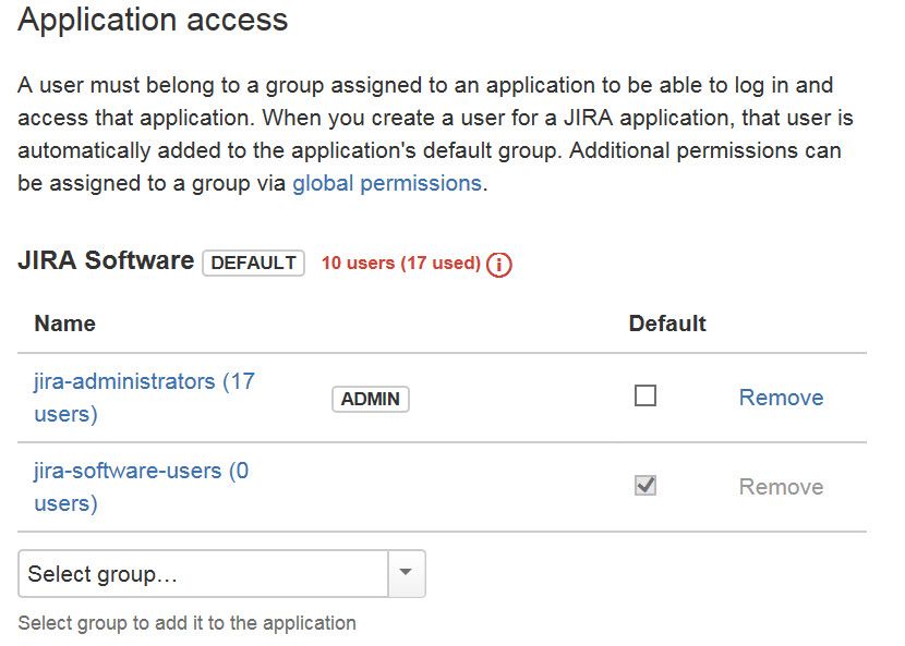

The missing piece for me is how you grant access to use Jira (not projects etc, just the system)
Can you tell us what you have in "Application Access"?

Hi Nic,
Tinker Fadoua
February 19, 2018
Oh you don't have any users under jira-software-users, and you have it as the default group

Ok, so this jira-software-users group was probably created by default I assume. We have Crowd configured to work with JIRA, when I set it up I crated the jira-administrators, developers, and users groups. But not the group shown as default above.
So do I need to add this group to Crowd and assign users to it?
Tinker Fadoua
February 19, 2018
Yes add that group to Crowd and assign it users
Charlie
February 19, 2018
Ok, I think that was it. I just had someone test. This person is not in the admin group, and they were able to log in.
The jira-software-users group was created in Crowd and populated but it is not showing up in JIRA yet with the users that were added in Crowd. So I added the Jira-users group as the default, and that seems to have worked.

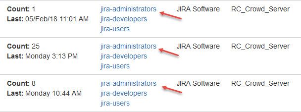

Charlie
February 14, 2018
Here's a capture of what every user account looks like right now. Again, what ends up happening is if I remove the users from the jira-administrators in Crowd, they're no longer able to log in to JIRA.

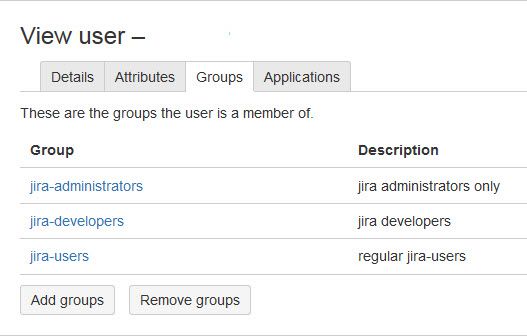

Did you check your DB see which group is the first one being used to log in?
Charlie
February 14, 2018
For pretty much all users this is what shows up:
They have all three groups. If I remove jira-administrators. They can't log in anymore.

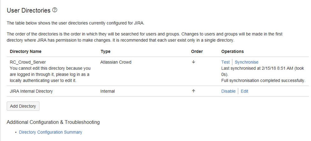

Can you please send a screenshot from your JIRA User Management Screen with your directories?
Charlie
February 15, 2018
Hi Fadoua,
Here's the User Directories screen:
Tinker Fadoua
February 15, 2018
I am thinking there is something wrong with group priority on the Database itself. I just asked a Professional Community Champion for his help.
