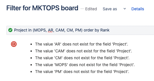

@John Funk I've tried to do this with a company-managed software project in Jira software and pull in Jira WM projects but they are not being recognized
when I use the basic filter, it only searches for projects in Jira software
This filter should do:
issuetype in standardIssueTypes() AND projectType = business ORDER BY Rank ASC

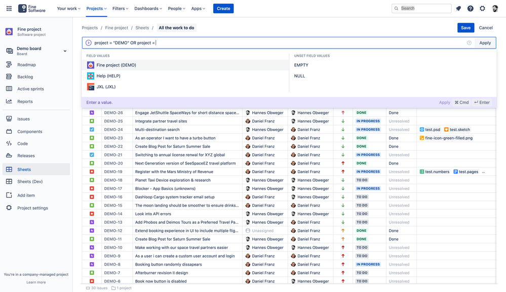

Hi @Maurizio Papa, to my understanding, JWM views don't let you do that (yet?). Is having a cross-project board view a requirement for you, or could other (interactive) issue views also work, if they are able to pull in issues from different projects?
It doesn't have to be a board... although a board would be the best I think.
But if there are other ways, I'm open to try them out :-)
M.
In this case you may want to try https://jxl.app. It gives you all the benefits of a full-fledged spreadsheet view, but is powered by JQL, meaning that you can pull in whatever issues you'd like to see, from any projects and project types.
(Disclaimer: I work on JXL :))
