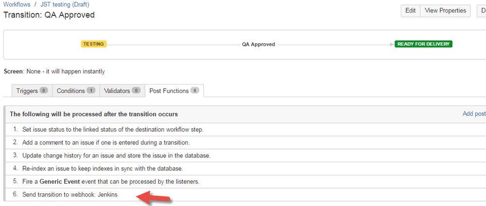

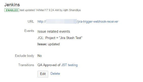

We are trying to trigger build in Jenkins using Jenkins Trigger plugin in Jenkins and Webhooks in Jira. I have cofigured it as Post function in one of the transistion and we have also made sure that firewall is open. When we try to run the test plugin in Jenkins is not getting triggered. In Jira devolopers doc it says if it fails for 3 times error will be logged in atlassian-jira-log  but we are not seeing anything in the logs. I wanted to know if anyone had the same issue or if something is wrong in the way I have configured.

I think you may need to deselect the Issue Updated event.
You can also increase the log level to debug for webhooks using #5 on these instructions: https://confluence.atlassian.com/jirakb/how-to-collect-data-for-atlassian-support-for-troubleshooting-jira-webhooks-397083035.html
