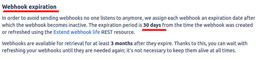

As it written in documentation every webhook created by Rest API should be refreshed every 30 days, otherwise they expire.

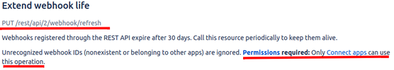

I found only one endpoint to do it, but it requires connect apps permission.
I don't need to create connected app. So how I can solve this problem?

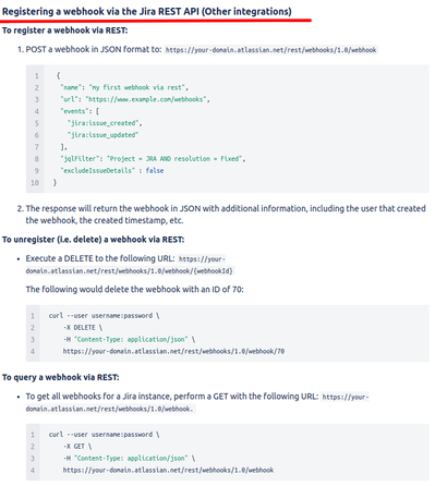

The documentation is a bit unclear indeed, but please notice that the REST API endpoint that you use to register webhooks for "other integrations" is different than the one used to register connect apps and does not need to be refreshed.
This is mentioned in the section named "Registering a webhook":
And indeed:
So, to summarize: it is not needed to refresh webhooks that have not been created from a Connect App.
