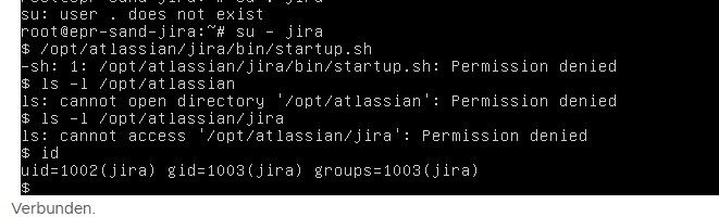

than i get an
Robert Wen_Cprime_
October 29, 2021
That's the prompt for the jira user.  The su command is working.

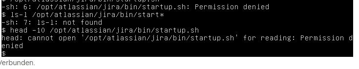

Ralf Thmas
October 29, 2021
still permission denied

What does
ls -l /opt/atlassian/jira/bin/start*
show us?
Also, can you try
head -10 /opt/atlassian/jira/bin/startup.sh

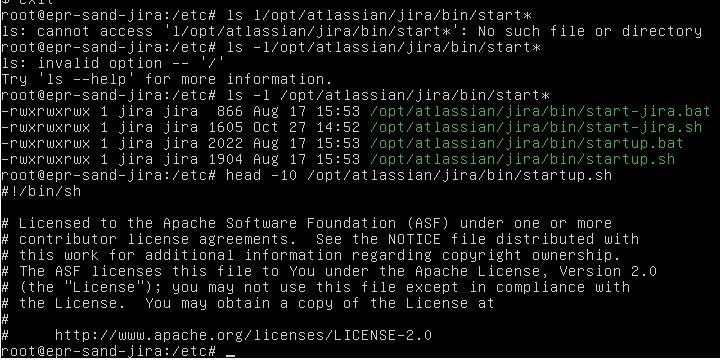

Ralf Thmas
October 29, 2021
Hello,
i get this
Greets
Ralf
Robert Wen_Cprime_
October 29, 2021
For the ls command, there needs to be a space between "ls" and "-l"
Ralf Thmas
October 29, 2021
ok. No permission

Robert Wen_Cprime_
October 29, 2021
As the jira user, can you type "id" and show the output?

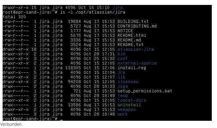

Nic Brough -Adaptavist-
October 29, 2021
Ok, so those permissions are utterly snarfed-up, but in a way that should actually be letting you do what you're trying to do.  Only other thing is that it might be the directory, so can you show us
  1. ls -l /opt/atlassian
  2. ls -l /opt/atlassian/jira
  3. id
For 1 and 2, do it as root.  For 3, as @Robert Wen_Cprime_ said, run it while logged in as "jira"

Ralf Thmas
October 29, 2021
Hello,
the commands
Screenshot 2021-10-29 181639.jpgScreenshot 2021-10-29 181607.jpgScreenshot 2021-10-29 181620.jpgScreenshot 2021-10-29 181607.jpg
October 29, 2021
We can't see what you are doing with half of those, there's four answers instead of three, and the first answer was to the third question but run for the wrong user.
Please, run questions 1 and 3 again, as the users asked for (your long screenshot shows us what you did and the results perfectly for question 2)

Ralf Thmas
November 19, 2021
Hello,
yes . Still no Permission
Greets
Ralf
November 19, 2021
Ok, so again, the "permission denied" when you try the "ls -l /opt/atlassian/jira" means that the jira user does not have the right to read that directory.
Assuming your jira user is the user with which you want to run Jira, then the most simple answer is to change the ownership of the jira installation and jira home directories so that jira is the owner of them.

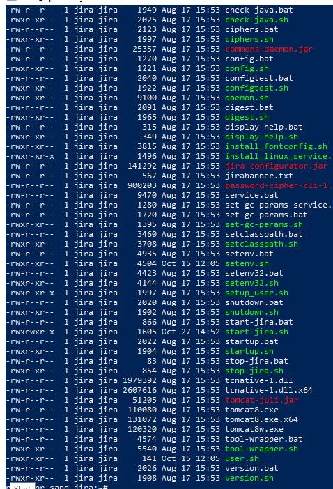

Robert Wen_Cprime_
October 27, 2021
Can you give the output of "ls -al" on /opt/atlassian/jira/bin ? Please send as a screenshot.
Ralf Thmas
October 27, 2021
