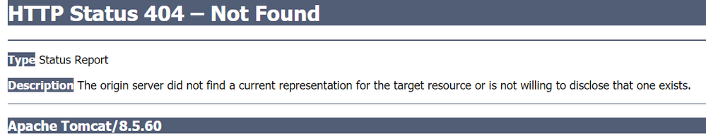

I have deployed a fresh Jira Software on my server with a HAProxy & Postgres but I am getting the 404 error:
MMCDNNc
Please note that:
