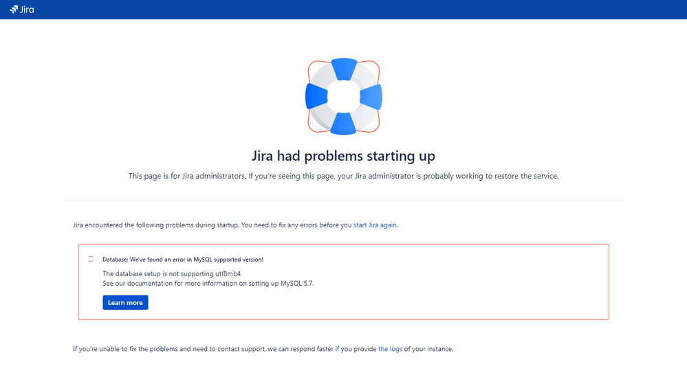

Deleted MariaDB and installed MySQL, now stuck on
'Database: We've found an error in MySQL supported version!
The database setup is not supporting utf8mb4'

It is very easy to fix, just drop the database and create a new one using the link below.
https://confluence.atlassian.com/kb/how-to-fix-the-collation-and-character-set-of-a-mysql-database-744326173.html
Or just use Postgres, its much easier just follow the steps below.
https://confluence.atlassian.com/conf64/database-setup-for-postgresql-936511499.html

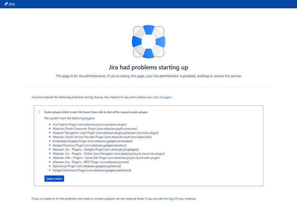

@brbojorque  After waiting a while, i get the following of on the start up screen;
screenshot-192.168.1.104_8081-2019.08.16-08_18_38.pngscreenshot-192.168.1.104_8081-2019.08.15-23_48_55.png

So it looks like you need to have an updated MySQL Driver for 5.7 version and enable the utf8mb4 in mysqld configuration.
[mysqld]
character_set_server=utf8mb4
Download Driver
For reference please read more.
https://confluence.atlassian.com/adminjiraserver/connecting-jira-applications-to-mysql-5-7-966063305.html

I used PostgreSQL yesterday and it was all so easy till I started facing permission issues at setup. This then angered me enough to remove both Postgres & Maria with the consequence of me losing all my other DBs
I'm making progress with MySQL now with the following you stated in link above;
Though I followed it before and didn't get anywhere, it is because they missed out a semicolon ';in the KB/guide.
ALTER DATABASE yourDB CHARACTER SET utf8mb4 COLLATE utf8mb4_bin;
SELECT CONCAT('ALTER TABLE ',  table_name, ' CHARACTER SET utf8mb4 COLLATE utf8mb4_bin;')
FROM information_schema.TABLES AS T, information_schema.`COLLATION_CHARACTER_SET_APPLICABILITY` AS C
WHERE C.collation_name = T.table_collation
AND T.table_schema = 'jiradb'
AND
    C.CHARACTER_SET_NAME != 'utf8mb4'
    OR
    C.COLLATION_NAME != 'utf8mb4_bin'
However, I've had to let Jira do the auto setup to for it to work and then change licence. Exhausting!
