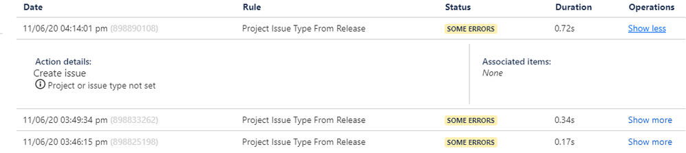

I'm trying to enable my first Automations on a Jira Software Cloud instance and the rules are consistently failing, I believe for permissions related issues, but I can't prove that.
The rule should create a new custom Issue Type named 'Project' when a new Version is added under the same Project's Releases.
The problem I have is that I always get an error stating "Project or Issue Type not set".
rulefail.pngI'm having a hard time understanding what that error means.  The rule is explicitly scoped to a single project and the "Create a new" action definitely indicates the Issue Type it should create.

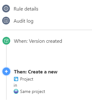

Rich Steenwyk
June 19, 2020
Atlassian support solved this problem.   The rule's Create Issue Action needed to have Project set to "Same project as trigger" and not simply (the default) "Same project" -- which, at first glance, appears equivalent.

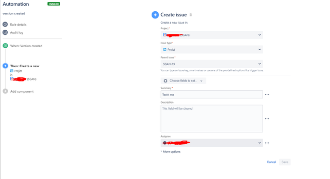

Hello Rich,
I have tried it on my instance and I was able to make this work by changing Same Project to ProjectXYZ, and also assigning a Parent issue XYZ-1 unde the create a New issue action. This is because creating issue Issue type "Project" is a sub-task and needs a parent issue key or id.
Hope it helps.
Rich Steenwyk
June 11, 2020
'Project' in my case is a custom issue type but it is not of type 'SubTask', it merely happens to re-use the same icon.
