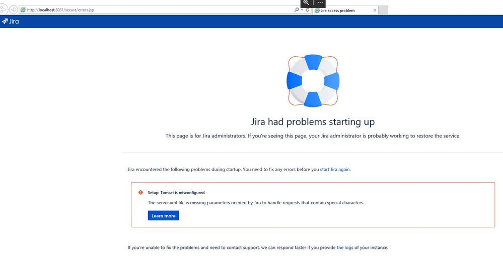

How should we regain access to the Jira application without loss of data and downtime.

Next; the application not starting. It's possible that simply re-running the installer will solve whatever issue you're seeing at startup. But if it does not, it sounds as if there were modified files on your system ("Jira admin page reported server.xml file error.server.xml file edited"). The server.xml file is where you'd configure what ports/addresses Jira will listen on. The installer may not have merged changes from your old configuration successfully. You may need to modify this file to get Jira to listen on the address/port you're expecting to use it on.
One likely cause is that special arguments that are included in server.xml in later versions of Jira didn't get merged in to your file. We've got an article describing this problem here, and I've copied the resolution steps for your convenience:
Go to<Jira-installation-directory>/conf, and edit theserver.xmlfile.
Find all connectors your application is using. Just search for Connector in the file, or look at the example below. You're interested only in connectors whose protocol is set to HTTP and HTTPS (not AJP).
Add
relaxedPathChars="[]|" relaxedQueryChars="[]|{}^\`"<>"to the connector properties inserver.xml. For example:<Connector port="8080" relaxedPathChars="[]|" relaxedQueryChars="[]|{}^\`"<>" maxThreads="150" minSpareThreads="25" connectionTimeout="20000" enableLookups="false" maxHttpHeaderSize="8192" protocol="HTTP/1.1" useBodyEncodingForURI="true" redirectPort="8443" acceptCount="100" disableUploadTimeout="true" bindOnInit="false"/>
Restart Jira.
Give those steps a try and let me know if that sorts everything out.

Hey Daniel,
thank for the reply I did opt to for reinstall and that put the service back and I was able to access the application as localhost.
new challenge is modifying the server.xml file to achieve external access. after the last change
