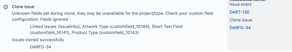

I'm not so sure where it went wrong but I got message stated:
"Unknown fields set during clone, they may be unavailable for the project/type. Check your custom field configuration."

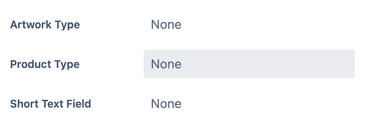

Hi @Patrik Korovsky  I already have these fields in the work management projects. Are these sufficient? The fields are there, however, it just wouldn't clone from the jira service projects.
I also checked the custom fields, it's currently under 2 of my projects.

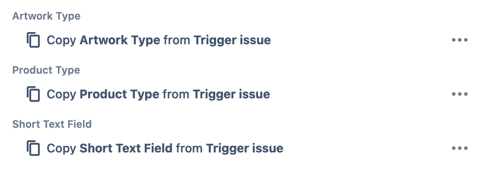

  1. Automation Rule: Navigate to the automation rule you have set up for cloning.
  2. Clone Issue Action: Within the rule, find the 'Clone issue' action.
  3. Set Fields Manually: Instead of letting the automation auto-detect the fields to clone, manually select the custom fields you want to clone.
    1. Under the 'Fields to Set' section, choose each custom field (like Product type, Short text field, Artwork Type).
    2. Specify that the field's value should be copied from the triggering issue.
      By explicitly defining the fields you want to clone, you can often avoid issues related to auto-detection or mismatches between projects.

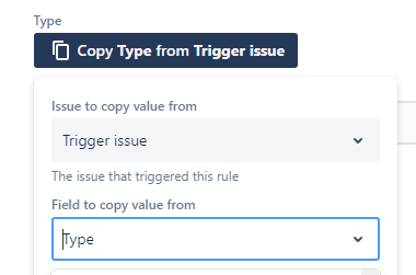

Method 1:
Copy from the triggering issue.

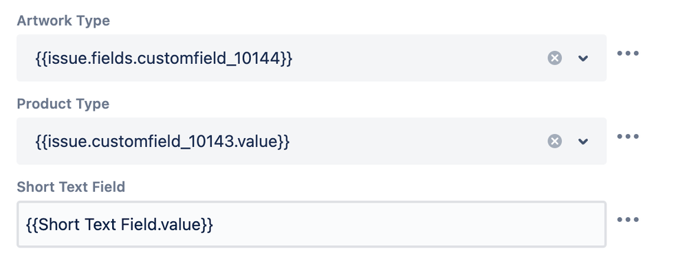

Method 2:
Use different smart values for possible outcomes
Screenshot 2023-08-17 at 8.34.33 AM.pngScreenshot 2023-08-17 at 8.32.56 AM.png
