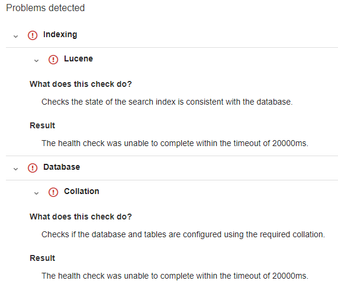

I have just another little Problem: At login at jira a message appears: "The Collation health check has failed in your system."
But I set the right collation in the db. The detailed error Message is: The health check was unable to complete within the timeout of 20000ms.

I think increasing the timeout is not the right way. The default value is 5000ms. So it must be done withing these 20000ms otherwise there is another problem.
The second error that appears is: Indexing (Lucene) with the same error message. If I run a reindex manually everything is ok. But if Jira does it itself (every hour I guess) These two errors appear.
Is the KeyAliase value influencing these operations?

September 26, 2017
Martin,
Can you show me the errors as they appear in a screenshot?
When you ran the indexing, did you do a background reindex or a full Jira lock and reindex?
There are a few errors listed here that you could run into along with their troubleshooting steps, but as far as I can tell the error you're experiencing is not listed here: HealthCheck: Lucene Search Indexes. Have a look, nonetheless.

I ran a background reindex, but no user did any changes meanwhile.
In Jira -> Systems -> Support Tools:
In the atlassian-jira.log file: image.png
