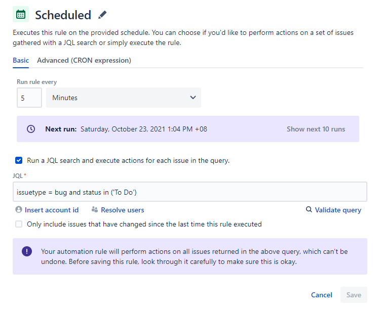

Jira scheduler automation was unable to group the triggered issues into bulk issues, the "more option" selection to enable bulk handling is not found/missing

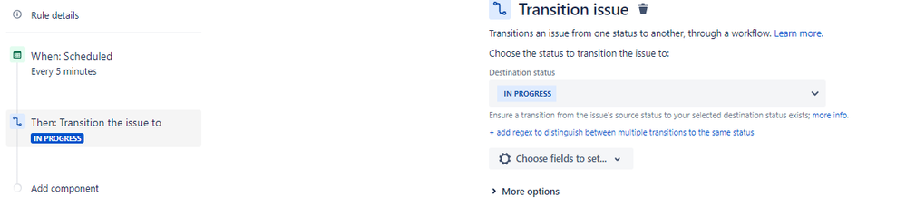

Hi @Yap Seng Choon
Once you have included the Scheduled trigger as shown in the image, you must include the action to perform, for example, Transition Issue. All those that appear in the JQL of the trigger will transition to the state that you indicate (as a bulk action).
I don't know if this is exactly what you need, but I hope it helps you.

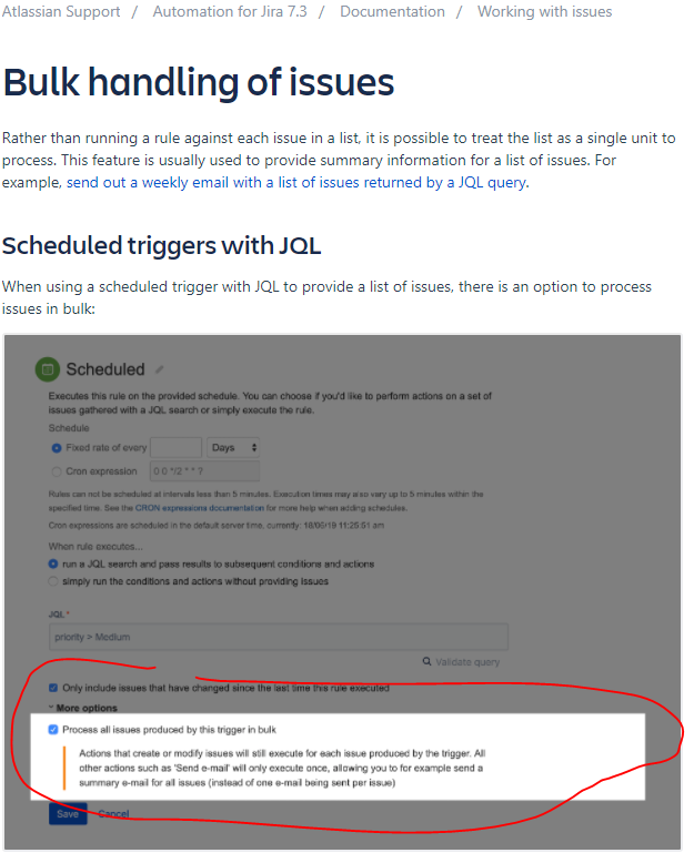

Yap Seng Choon
October 24, 2021
im following this guide(Bulk handling of issues | Automation for Jira Data Center and Server 7.3 | Atlassian Documentation) on how to handle bulk triggered issues and i need this "more option" from New:Scheduled so that i can bulk process the issues filtered from JQL, but i cant find this options from Jira cloud
