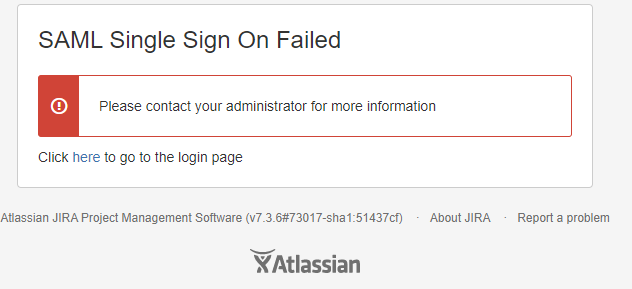

JIRA SAML is failing with no changes by any admins to Azure AD. No one can get in to administer since SAML is failing; error is just "please contact your administrator".
How can admins get past this to troubleshoot?
All necessary fields in the single sign-on have been filled and not changed.

It seems that the signing certificate (X.509 certificate) has been changed on the Azure AD and because of that SSO is not working as JIRA is unable to validate the signature in the SAML Response.
It looks like you are using the third-party SAML app from miniOrange. If yes, you can use the emergency URL to access the default JIRA login page and update the certificate from the plugin configuration.

it looks like you are using our plugin (and not the one from miniOrange, unless their error screen looks like ours).
If it's our plugin, then here you find information on how to access the instance by either using the special ?nosso URL
https://wiki.resolution.de/doc/saml-sso/latest/all/knowledgebase-articles/technical/cannot-access-jira-confluence-bitbucket-bamboo-fisheye-crucible-anymore-bypass-sso
Or if you did disable that in the Config, then here are some instructions on how to start wiht our plugin disabled:
https://wiki.resolution.de/doc/saml-sso/latest/all/knowledgebase-articles/technical/application-startup-issue-disable-sso-plugin
