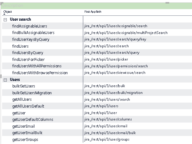

This has turned out to be more interesting than I thought.  I want to go a little further, but here has what I've realized so far.
There are "User" endpoints and "UserSearch" endpoints.   Your variation seems to be the Search (single "user" in the path) which would seem to be Jira oriented based on the endpoints
I have tested the Users variation and it works exactly as you expect  (users plural in the path).  It seems to be more system/instance .. not Jira App specific
Both User and UserSearch say they return an array of users and both support the statrAt and maxResults parameters.   I may update your question once I confirm when/why/where on User "get" is appropriate versus trhe other.
I am going to work little more-- and I am surprised I never noticed.  The screenshot is from an internal tool... if you go to the atlassian documentation, both endpoints are there right next to each other
thanks

Hello @David Nickell
The OP's question is about Jira DATA CENTER's V2 REST API endpoint... but you are showing and talking about endpoints from Jira CLOUD's V3 REST API, which is a totally different thing in a totally different product.
