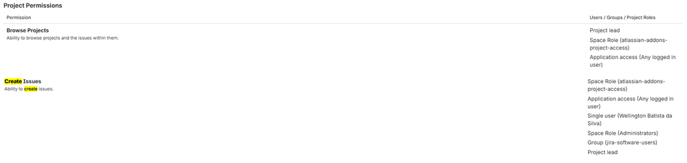

Please find attached an image showing how the current permissions are configured.
The project is Company-managed.

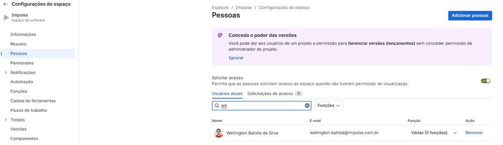

Hi @Wellington Batista da Silva
In the people section of the space settings, are you listed there?

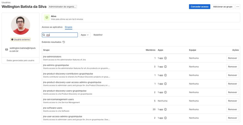

Can you access User Management, find your self and what is your permission on Jira.

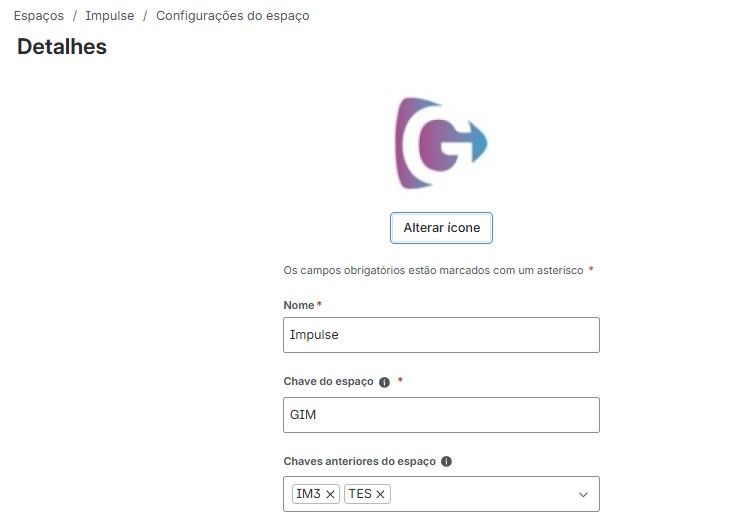

Check in space settings, in details of the key is set to GIM
My user is listed in the 'People' section of the space settings.
Yes, please find attached the User Management details.
Space
What does it say at "Acesso ao aplicativo"?
What are you roles at "Funçoes" at the project access?
If you have a Jira license /rest/api/3/project/search should give you results, if not it's permission issue
It seems like the role project administrator has no permissions defined in the permission scheme.
