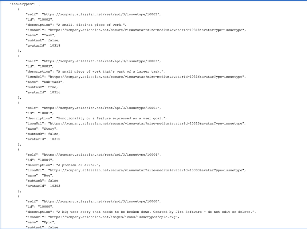

I have recently started interacting with JIRA Rest APIs and I am simply trying to create an ISSUE for a particular PROJECT.
I get a response which specifies what issue types exist in the project, and I try to use the TASK with id 10002 as the parent for the issue I am trying to create.
Here is the response I get about the project for reference,
But when I do this, I get the below response.
{    "errorMessages": [],    "errors": {        "project": "Sub-tasks must be created in the same project as the parent."    }}
In both these calls, the project Id is the same.
Can someone please suggest what can be done here?
Much thanks.

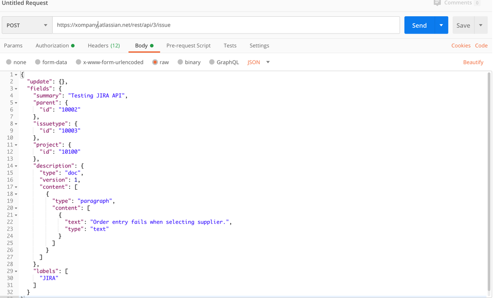

Hi @Benjamin, here are the call details:
APIhttps://xompany.atlassian.net/rest/api/3/issue
type : POST
body : {
"update": {},
"fields": {
"summary": "Testing JIRA API",
"parent": {
"id": "10002"
"issuetype": {
"id": "10003"
"project": {
"id": "10100"
"description": {
"type": "doc",
"version": 1,
"content": [
"type": "paragraph",
"content": [
"text": "Order entry fails when selecting supplier.",
"type": "text"
"labels": [
"JIRA"
Nic Brough -Adaptavist-
May 23, 2020

Shiv Kumar
May 26, 2020
An Issue does, yes. But I am trying to use An Issue Type as the parent, and this issue type does not have a key.
The image on top shows the issue type 10002 that I am using as the parent for the issue that I am trying to create.
The attachment shows the request body.
If I am doing this wrong all-together, pls do suggest the right way with an example possibly?
Thanks again!
May 26, 2020
Ok, I think you are misunderstanding the issue/sub-task relation.
An issue type can not have sub-tasks. They're not issues, they are an attribute of an issue.   Only an issue can have sub-tasks.
You appear to be trying to attach a sub-task to an issue type.  Where you're using issue: 10002, that's probably an existing issue in another project, hence the error message.
Try attaching the subtask to an issue in the SUB project.
Shiv Kumar
May 29, 2020
Hi Nic,
Yes, you are right.
I had misunderstood it.
I had to do Sub-task->Task.
But instead I was doing Sub-task->Issue Type.
Thanks for pointing it out.
