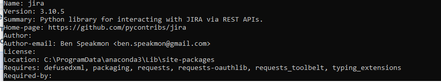

@Vivek Patel Check your Jira module version. version 3.8 definitely still calls to v2, where it looks like 3.10.x should fix the issue. 3.10 requires python 3.10 so you might need to update your Python setup before you can get the never version of Jira module to work. I'm working on it myself so will let you know if i got any luck.
@Vivek Patel I did upgrade from 3.8 to 3.10.5 and my issue have been solved. I have a Linux setup with Python 3.10.12 and Jira 3.10.5.
I have Python 3.12.7 installed too. Not sure what is issue here. :) @Bartosz Debski
I suggest to fully remove jira module and reinstall from scratch. It might be that module, for some reason is not installed properly and your code still loads old one ?
Finally working now !
